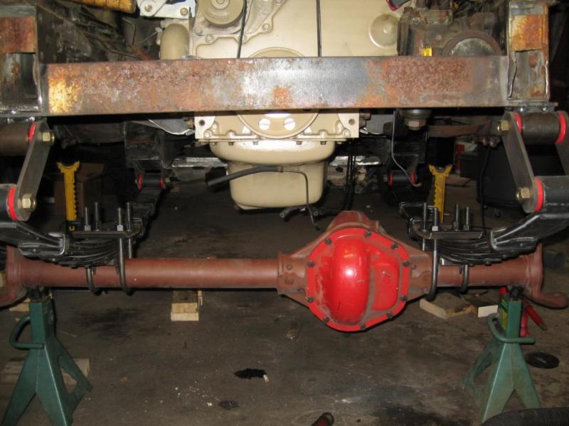

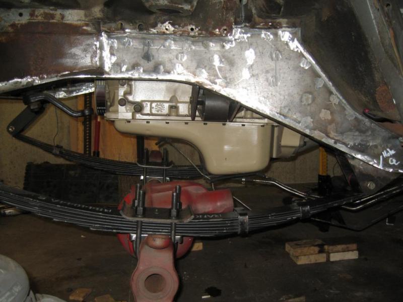

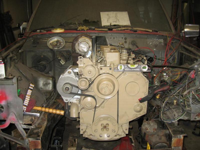

I saw a 4bt stuck into a Comanche. IIRC he had to go with a fair size lift because the engine was so tall. He had like a 8" lift and had the bumps lowered to limit the up-travel. The owner said the power was amazing though.
Here it is...http://www.youtube.com/watch?v=KyS9A3jbwLM&feature=related
Yes this motor is tall
What build is that from Goat? I'd be interested in looking through that thread
could the motor have been lifted up higher if hood clearance was not an issue???
I am thinking of doing a 4bt in my cherokee and if I have to I will build a cowl hood just dont want to go over 6" of lift
