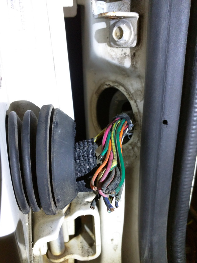

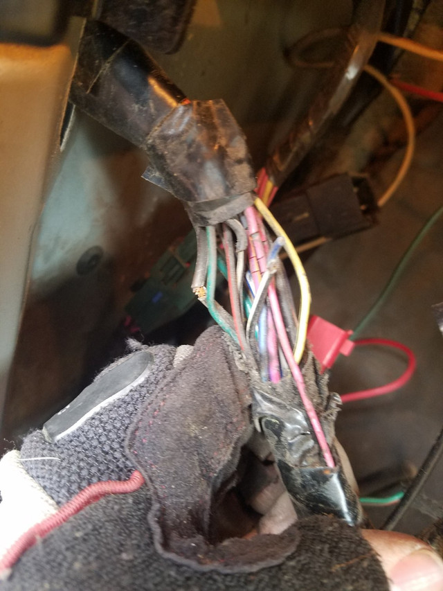

Tim_MN Freakish Hand Strength NAXJA Member Location Minneapolis, MN Monday at 10:45 PM #2 The drivers door and tailgate wire harnesses are a common failure point. 12 volts positive shorted to another wire circuit, a speaker wire, or to ground would likely cause those symptoms. .
