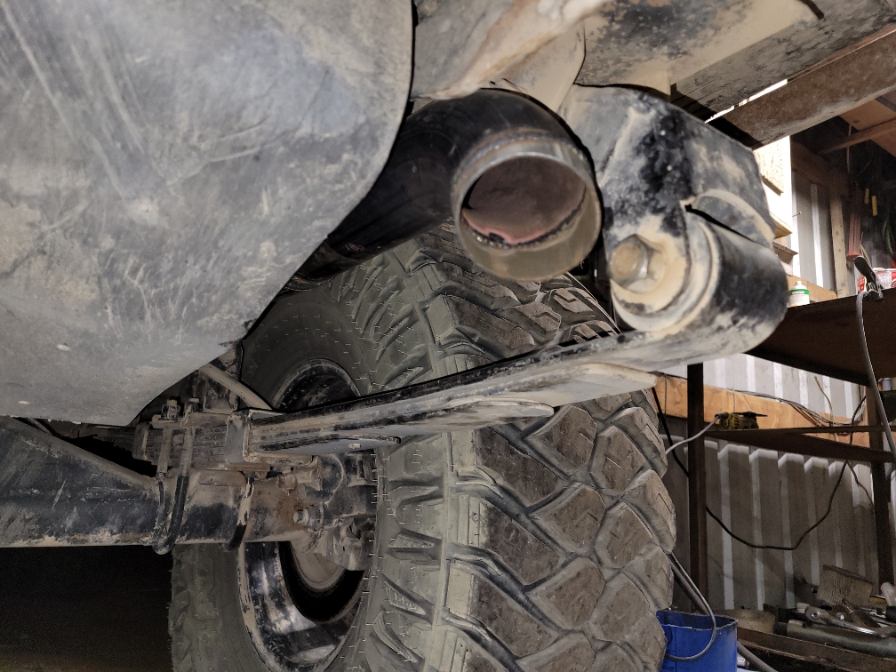

I have built several low cost leaf spring packs for a budget boost. They are also called bastard packs if you use Chevy S-10 or Ford explorer leaves in your Jeep. I used a stock XJ Cherokee leaf spring pack and added a 2.5" Rubicon express full-length add-a-leaf. It worked very well, but I needed a bit more room for 31's, so I installed an additional single XJ Cherokee leaf into the same pack. That netted 3.25" of lift, excellent pavement ride, flexes very well off-road, and it handles 250lbs in the receiver hitch rack and another +100 lbs of tools in the cargo area. It also tows trailers very well. This set-up has worked so well, it is now installed in another XJ.

I basterd pack a brand nee crown heavy duty leaf pack. My jeep is pretty heavy this rides well and handles thecweight. I got about 2" out of this pack after adding leafs. There's 6 leafs total

Every Jeep is different, but I have boosted several flat XJ leaf packs with an additional leaf, XJ and Chevy S-10. When I did the first AAL, RE 2.5", it went into an OK condition leaf pack that was not fully flat. The lift was about 2 inches as I recall. I added an additional XJ main leaf with the spring eyes cut off because I wanted to have 3 inches of lift and a bit less squat with a full load of cargo.
