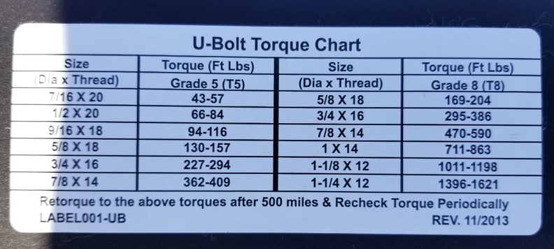

Deaver has a chart. I will post it tomorrow. 5/8 grade 8 ubolt is 169. Grade 5 is 130.
This chart comes [sometimes] attached to Deaver springs. It's what I use to torque.
I assume ruffstuff ubolt are grade 8, but holy hell thats some serious torque for a U bolt. More than tripple the stock bolts, at what point would one worry about this damaging the axle housing?
