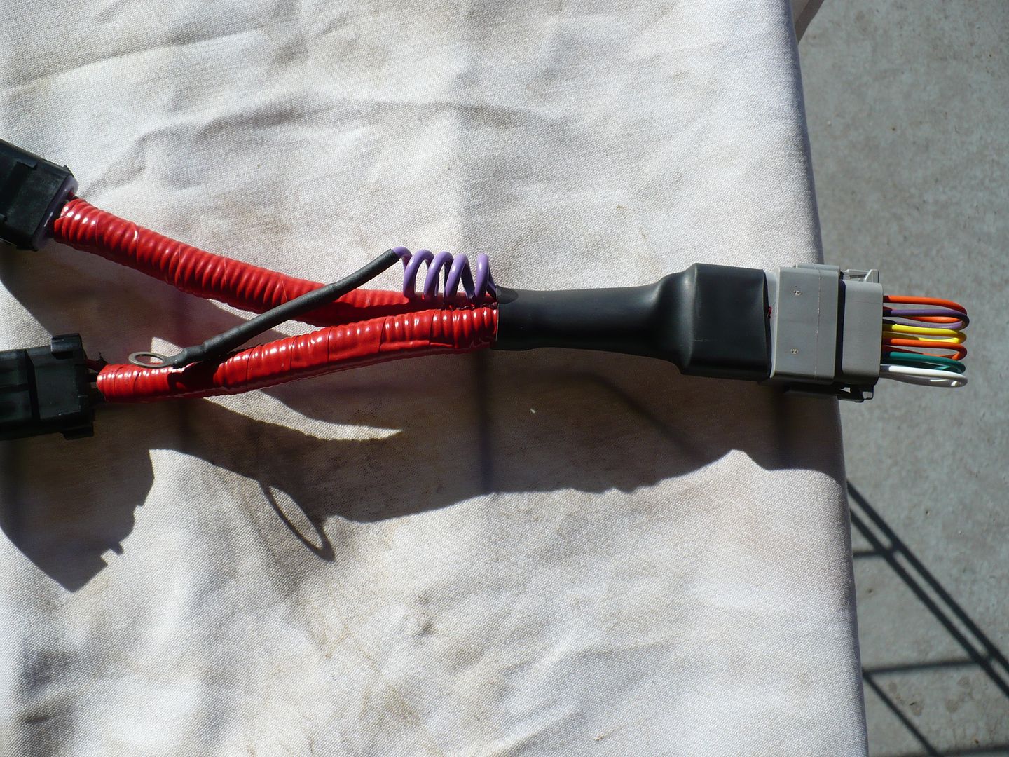

All you have to do is plug in the by-pass adapter included with the unit!

Also, the viper coil conversion allows you to run any year cylinder head without worrying about the 00-01 coil rail.
So that bypass harness will allow the Jeep to run when the msd fails? I'm not running a big cam, high compression, boost, or nos so a msd has no use to me unless I want a smoother idle, which they do with multispark. The viper coil sounds interesting. Any write-ups? How's it work as the viper is a 10 cylinder vs a 6 for the Jeep?
Where'd you find the tupy head?
My cylinder head was originally from Clearwater Cylinder Head but was gone thru with the full works by Russ. Yes that plug bypasses the MSD if needed and the Viper uses 2coils (1x4,1x6).
