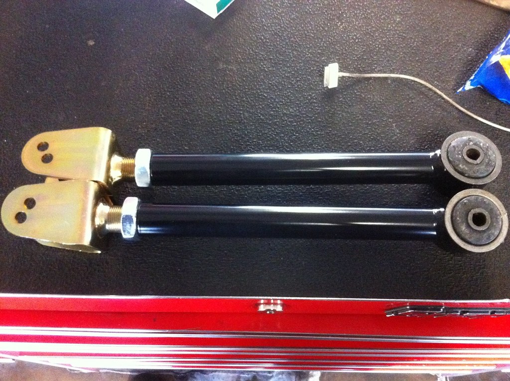

Upper controls arms came in today. Played arround with different lengths to find the happy setting for caster and pinion angle. So far no signs of any DW after install. So I am hoping I solved my issue. Also all the driveline vibes are now gone.
