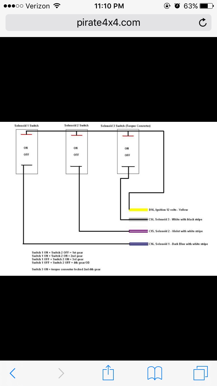

I found this pic which helps but im unsure of how to wire the switches in? Like how would i make it to where the tranny gets overridden it seems with this setup the tcu would still work as it normally would
You're over thinking it. Cut the power wire to solenoid 2. Install switch to wires you just cut. When switch is closed, trans operates as normal. When open, no signal goes to the solenoid so you only have first in the 1-2 position. Done.
Yeah i looked at it again and thought that would be the case, the way the diagram was written up i couldnt tell if one side was power and one was ground or if the computer sensed when to send power to each solenoid makes sense now
