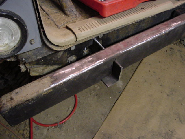

I hate to be a stickler, but I'm looking at the pics where you're painting them. I dont' see the eight additional holes that were to be added to the widened builkhead mounts and the inner frame rail strip doesn't seem to have any holes in it either. Is it just an illusion in those pics?

Good eye. The frame rail strips didn't get drilled until after the bumper was painted since my welding buddy ran out of time and had to go to his "real" job. So the holes were drilled and nuts welded to the stips the next morning.
As for the 8 extra holes, I still haven't gotten to them. They'll hopefully be done by Fall Fling.
Thanks for the compliment on the welds, but I didn't actually do the welding. My welding skills are fair, but the guy who did them for me was a boiler welder for 40 years and offered to weld it up for free. I would've been a fool to pass that offer up.

the method of attachment is baisicly the same and i am tieing in the bumper too the tow hitch as well to create a sandwich out of the "frame" rails ( the hitch mount goes to the bump stops ) and i used two pieces of 3/4 in plate for the clevis mounts, i will give more details as i finish it up but for now here are the only pics i have of the bumper
boy i need a better camera
still need to trim the rear quarters and finish all the welding but it was truly well under $100 by about $95.50 ( $4.50 for electricity at home ) i will finish welding it out at my work in the next few days

Nice job, however I have some food for thought. you stated that it was attached to the jeep with 22 bolts, however when you use your hitch to pull you are pulling off of 1 pin that is a total of 1/2" thick. Oh and when you load your jeep on a trailer behind your tow rig you haul 6000# off of that same 1/2 pin....I think We (including me) over bolt a lot of parts...I guess more is better than less..

i just skipped using the weak factory bolt locations on my rear bumper altogether
So you just used the holes in the frame rail? Since a tow hitch only uses those holes, it should be strong enough, but it would still make me a little nervous. I like the stepped look of your bumper, by the way. I'm thinking of doing something similar in the front.

yes. I was originally planning on using some of the original bumper mount bolts, but I wanted my bumper as tight to the body as I could get it, and I wouldn't be able to get to those bolts if I had. I'm not worried about strength, since the received I used to recover from didn't mount in as many places and worked just fine.
The bumper was made from my old rock rails, so it was a pretty cheap build for me also ;)

If you are planning on going in the frame rails like that you need to reinforce it though if you plan on running a swingout.
Mine is set up this way and the frame rails are starting to split on the bottom. It is just too much weight.
