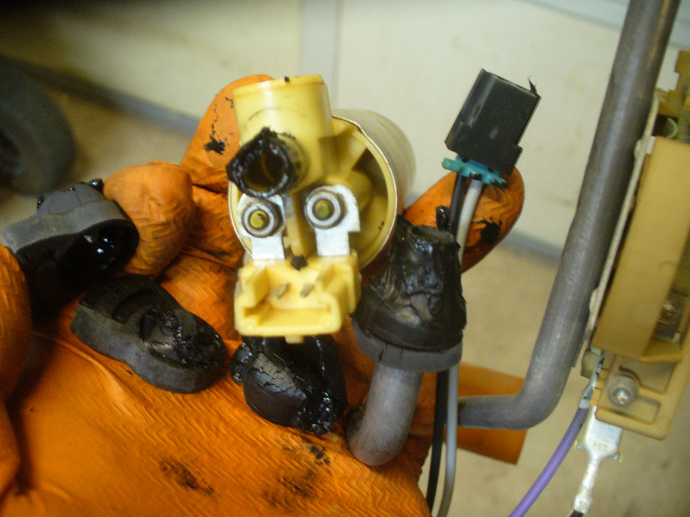

Once parts arrived and I got the bed off and hosed off decades worth of dust and debris I pulled the pump and found this:
Note that this was a job done by a professional mechanic.
And that is why you pay attention to fuel line types.

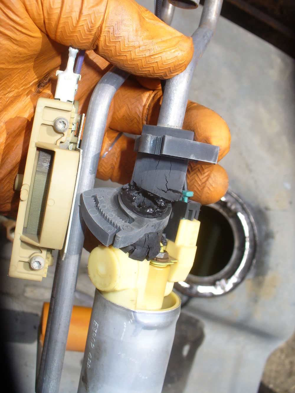

This is how that came apart:

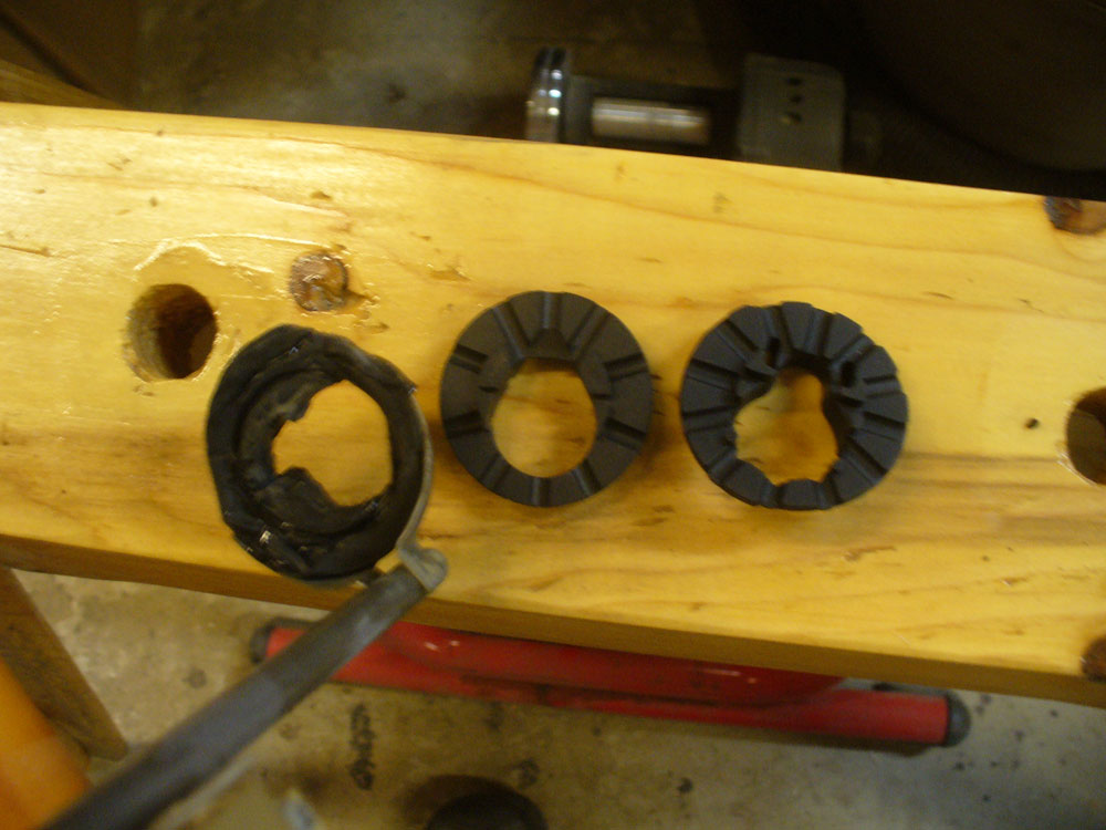

Note that I don't think the mechanic deliberately swapped in cheap fuel line. Reason being, the cushion at the bottom of the module was in the same state:
The issue is the quality of parts used by the professional. All he had to do to get his money was to get the truck running again. By the time any problems came up he could safely say it was out of warranty.
There is a reason prices vary on parts.

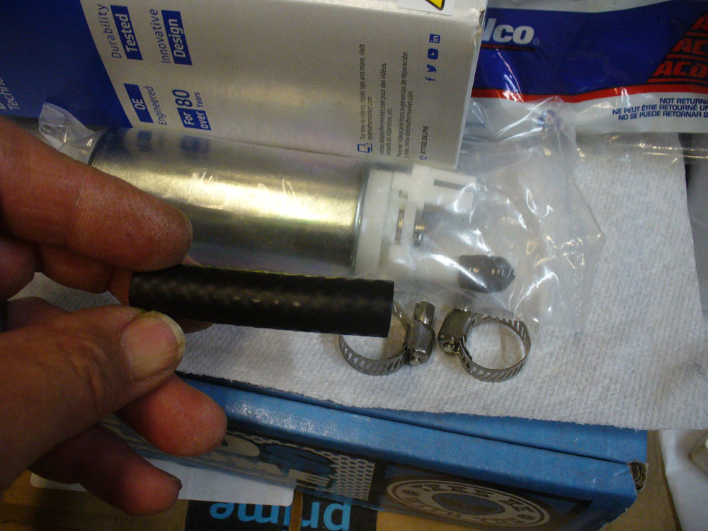

I went with a Delphi pump. It came with very different fuel line and clamps:

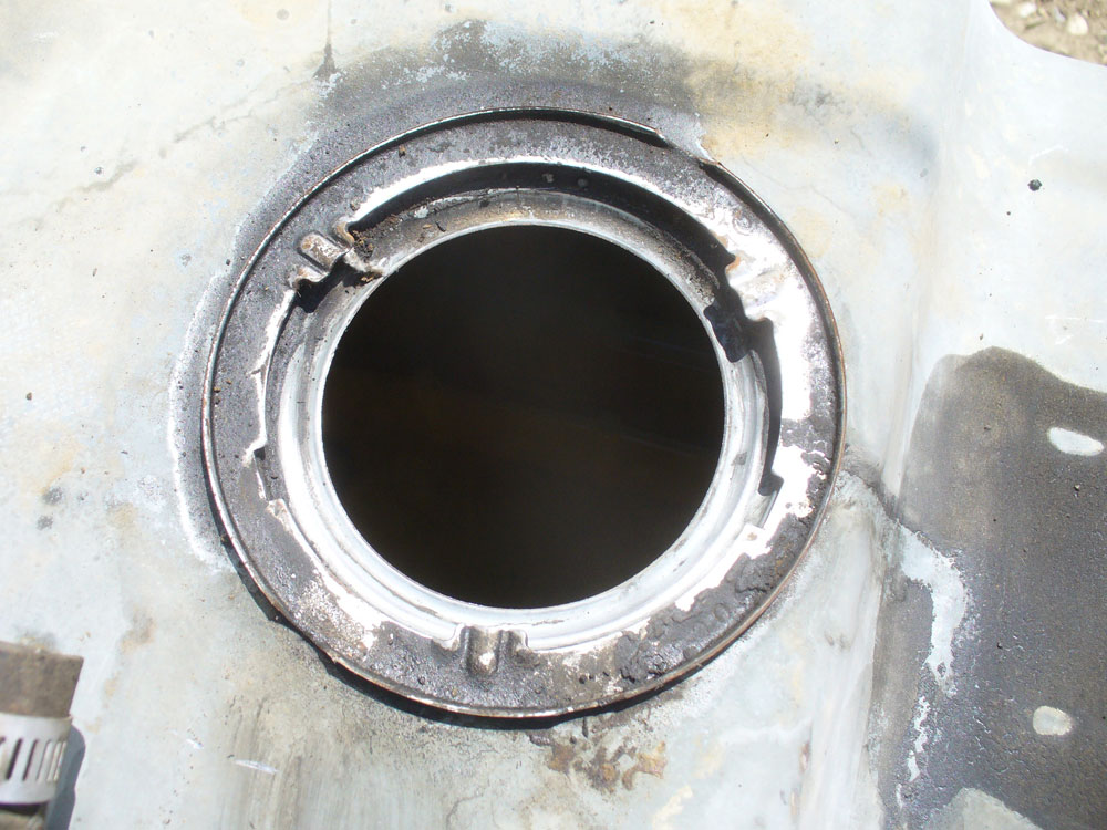

Looking at the tank you can see another thing the professional failed to do:

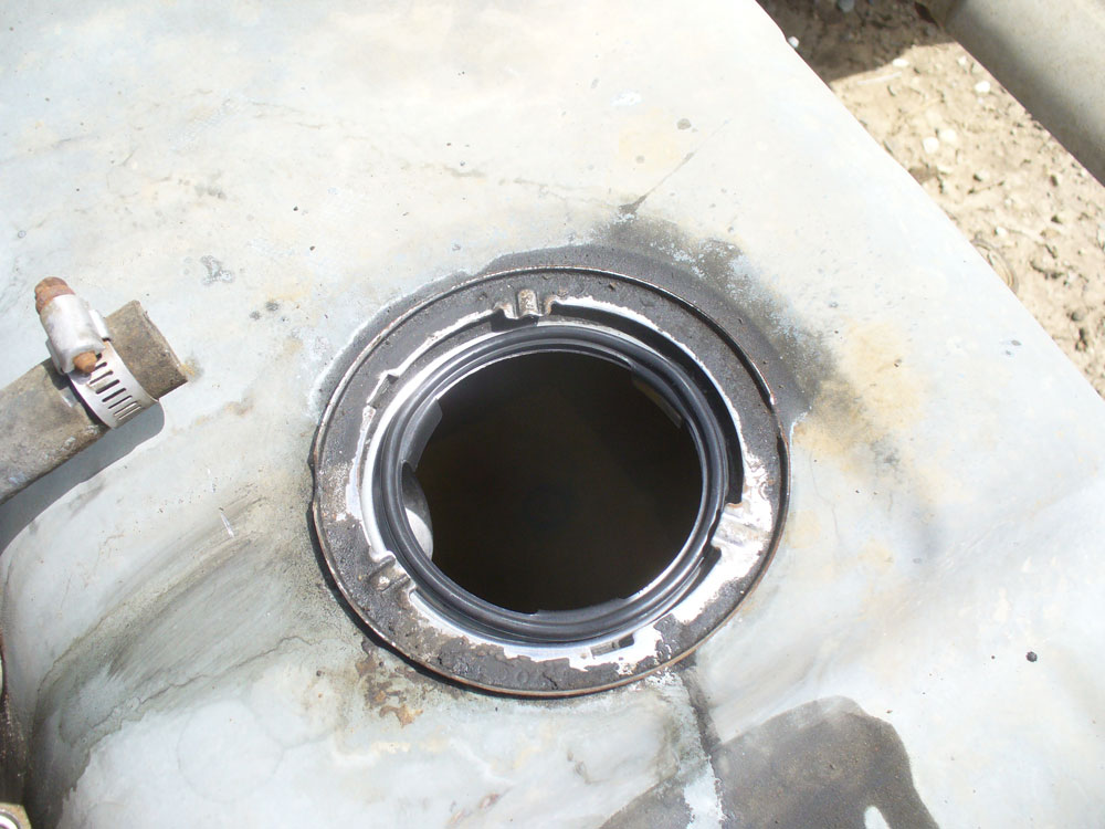

The sealing surface was never cleaned. You can see the difference where I started wiping it clean. Odds are the mechanic did the bed tilt method of replacing the pump. Access is poor that way, and never gets good. If you fight to drop the tank you at least gain good access once you win the battle. Tilting the bed never gets you good access. You do the whole job badly. And this is one of the reasons that method is the worst option. There is no way to clean the sealing surface of all the dust that falls in when you pull the pump assembly. You end up sandwiching all that dust in place. Dust happens to make a poor sealant. This is how that surface needs to look:
And this is a better gasket. The tabs make sure it stays centered. (Edit: P/Ns for this gasket are ACD# G10 and GM# 22515965)

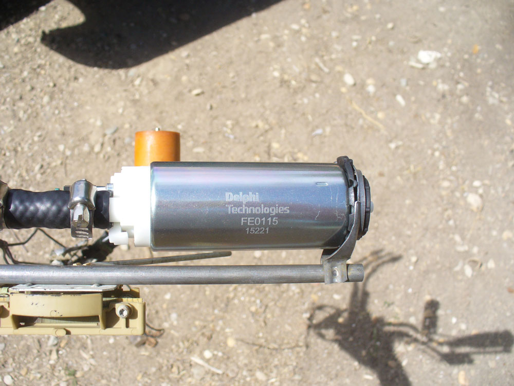

Here is the new, better, fuel pump with what should be the right type of hose:

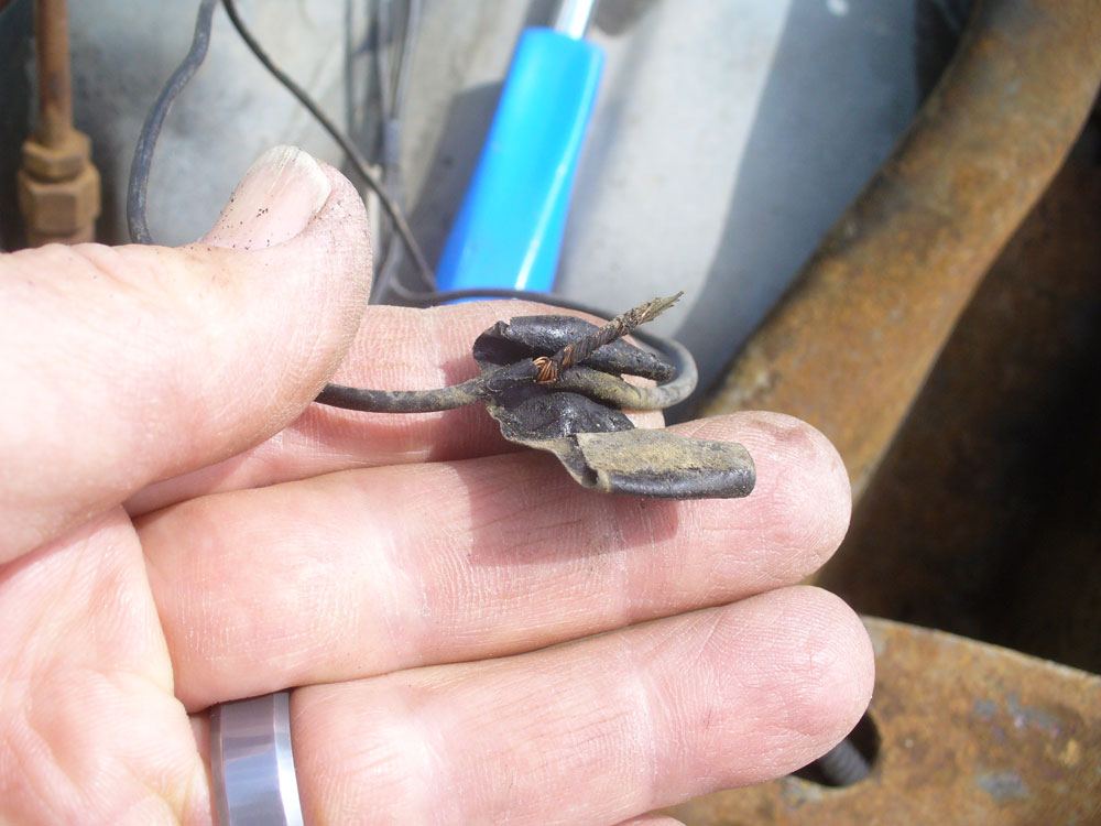

And here was the cherry on top:
The professional mechanic evidently didn't do well with disconnecting the fuel pump ground, cut it and spliced it by just twisting the wires together and taping them. Yeah. Professional.
The difference between a professional and an amateur is that the professional does it to separate you from your money. The amateur does it for the love of it (amateur-amor-love). I have very little use for the professional.
