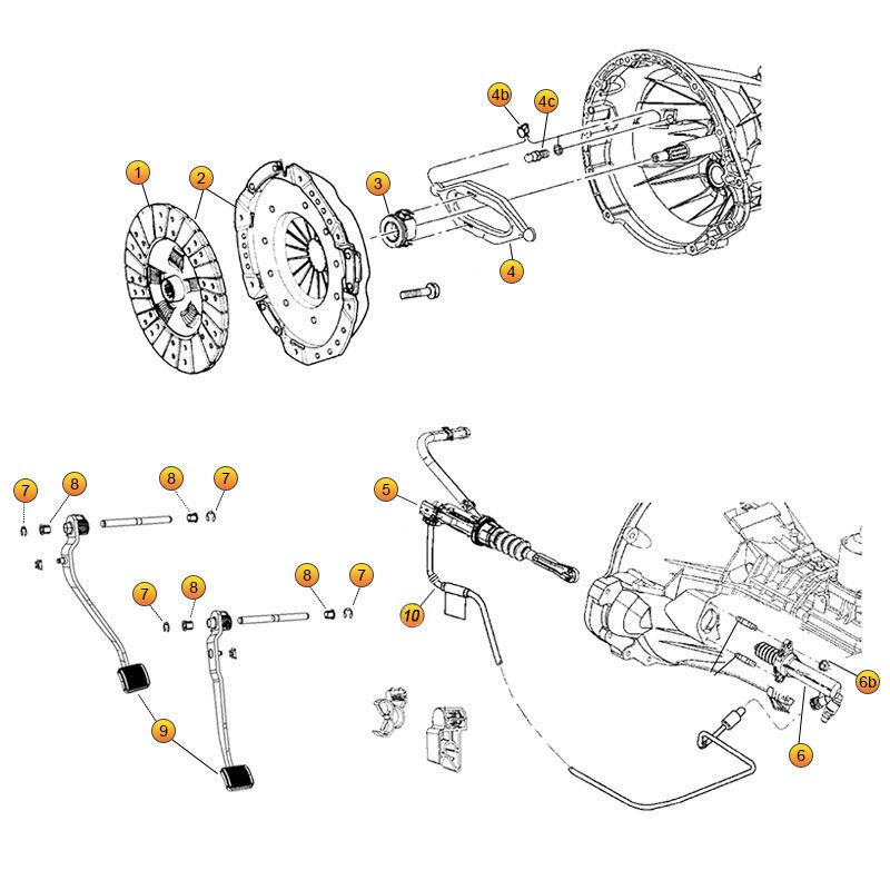

The most help I can offer is suggest you look at this diagram and then try to look at your Jeep and figure out what is wrong (diagram is for a JK, but I doubt things are much different on an XJ):
A simple fix could be if the master has come disconnected from the pedal somehow.
I suspect more likely is that item #4 (what would traditionally be a clutch fork) has an issue of some form, either having lost its pivot point or having worn into the throwout bearing or something like that.
It is all speculation on my end.
Good luck, and let us know what you find.
