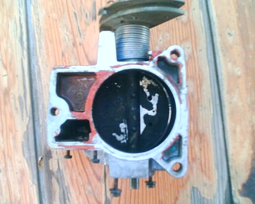

On your left is the renix throttle body and at the right the vortec tb.
This is the difference in size between the Renix vs vortec butterflies 52mm and 75mm.

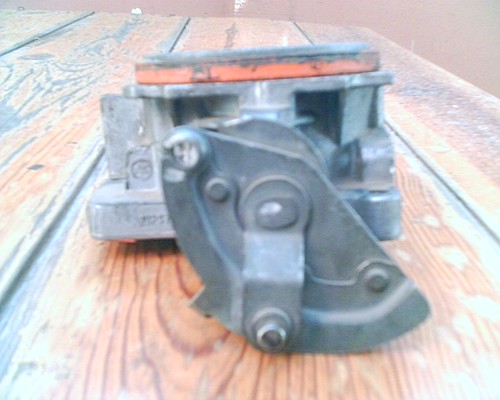

Renix sensors and vortec are in the same side.
The vortec throttle opening is the same way that the Renix.

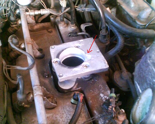

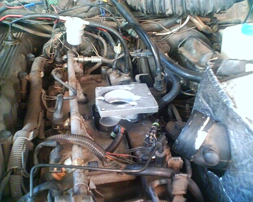

This is the custom aluminum base.
The measurements are 4 "x4.5" x1 ".
I drill a breathing window so the iac valve can control idle.
The bore is 62mm.

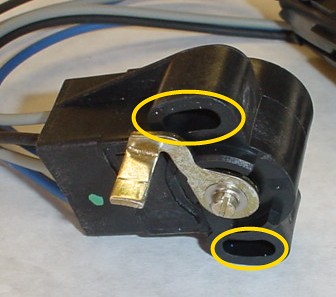

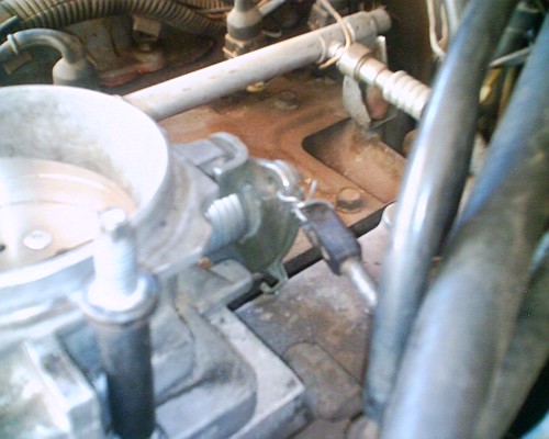

This part is the most complicated because it requires finding a way to match de renix tps with the vortec tb shaft. Usually a small tube welded to the shaft to move the tps lever is used. there are a lot of "renix to HO tb" threads showing how to do this mod.
You must do more drilling out the 2 tps grommets, are like 2mm on each hole.

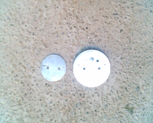

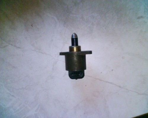

Another important point is the iac valve. We use the same one that comes with the Renix but with some modifications.
The head of the Renix iac is smaller than the vortec, but only use the vortec pintle . You can unscrew the pintle with a little DW40 help. Also I put 3 O-rings for a better seal as indicated by the arrow.
Renix iac valve fits perfectly into the hole on the vortec but one of the pins is as 2mm more toward to the center than the other, should be drilled as 2mm inward.

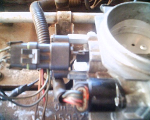

Assemble the TPS with the 2 4mm x 2" bolts and 2 1" spacers and calibrate the tps to yours tranny specs.

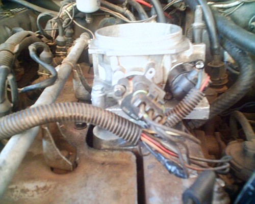

Another view of the vortec Thottle body mounted on a Renix admission.
I made a small hole with a drill in the accelerator linkage bracket so it can pass a wire and tie to the tb pulley .
Another modification that has to do is relocate the MAP sensor vacuum. I join it together with the ventilation´s vacuum hose.

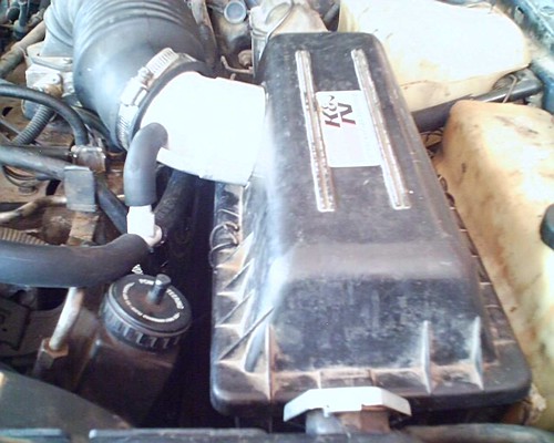

In the mouth I put a 3" PVC pipe and seal it with JB Weld .
I let it dry and paint it.

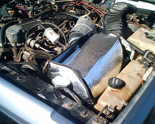

Here is armed and wearing the bonnet.

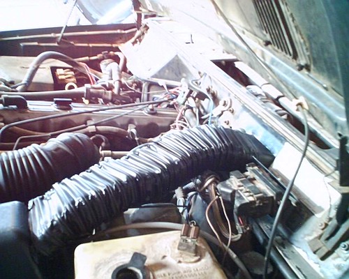

Connect the air box lid with a 3" air hose.
Protect the air intake with sun shield to make it CAI.
