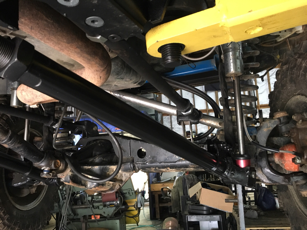

Been awhile. Working on mounting the Ram assist. Made a clamp to use. Waiting on the front skid system we designed to guard the ram behind the tie rod. I don't have pics of the drawings but should be getting our first pieces this week.
Until then she sits for a minute until I can get a new pitman on and the ram at least mounted so I can figure out line lengths for the box. Then Power steering cooler and filter.

Hydro assist is done. Testing Pending for this weekend. We designed our own pretty cool steering skid as well.
Its a 1.75" x 8" PSC Ram. More than enough for this build.
Still have get the rest of air out the system. There's a lot. Too cold to continue tonight.

Had to swap out the 8" stroke ram because I'm an idiot. Basically for a Saginaw box you need a 6" stroke ram and nothing bigger. Even when your box is at full lock, the ram is still pushing. So your hydraulic ram vs your knuckle is a very one sided scenario. Got it all fixed now.
Power steering cooler is also installed with a 4" Spal fan. Haven't wired that in yet though.
Steering couldn't be more happy right bow.

This is a Rubi D44. Same width as a 30 though. Its more about what the box calls for. A Saginaw box calls for 1.5 turns of the wheel for left or right, which moves the steering 3" left or right. 6" takes the cake. Once the steering is at full lock, pressure is still pushing the ram out which means an extra inch of stroke would push and basically try and rip my knuckles off or just break something else.

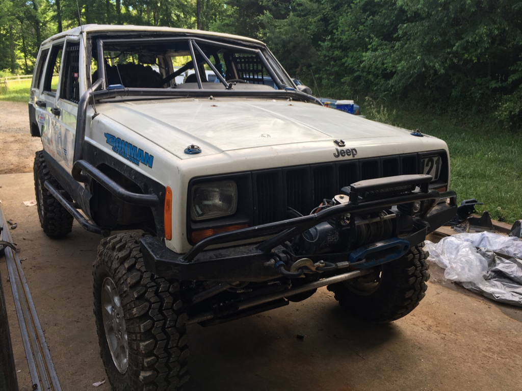

Got my Dirtbound Offroad front bumper hoop bits in. This is the first step in bracing the fire wall to the bumper. I will say I wish it was a 1.75" diameter tube like the rest of the cage, but I think this will due for my application.
Rigid lights are on there way. Super stoked. Two blue pods, a 10" white single row bar and a flasher unit for being really annoying. Trick tabs from Barnes4wd also inbound for mounting.
