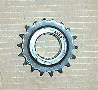

I run the Cloys 9-3127 in my stroker, not because I think the motors "have" to have it, but because I think that if one is spending the large sum of money to build a stroker it just makes sense to build it as strong as one can. I put it under the "cheap insurance" category.
This is what my relatively low mile "regular" Cloyes looked like when I pulled the motor down for the stroker build:
I think the extra money is well spent on the magnafluxed gears and a more substantial chain.
