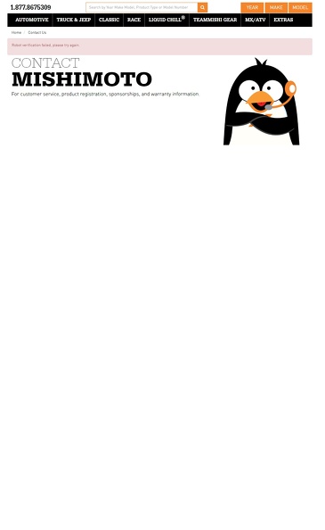

FYI, your site has failed to let me register about 5 times now. I'll try it again in a couple of days.
