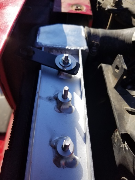

This looks like a cracked weld? That's a little disappointing to find on an otherwise beautiful $400 radiator. Given the location I don't think it would stop me from installing it, but it would have stopped me from shipping it.
Makes you wonder what they are doing to make that weld crack. And are they doing the same bad thing(s) on important welds.

I have to agree, a crack like that isn't typical in aluminum -- I'm wondering if the bowl is compromised and going to leak right there
Are there any other welds holding that crossmember to the bowl?
stress crack isn't it? didn't think they were that uncommon. weld shrinks but the base doesn't, but I'm rusty on AL welding.

I’ve never seen a crack like that on aluminum, although I tig weld all my aluminum
