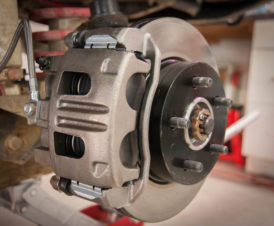

Finally finished the VANCO Big Brake 15" Kit install. Also had a unit bearing that was going all wobbly, so I decided to replace both unit bearings, all 4 ball joints and both axle u-joints.
Completed the first few runs of the required break-in procedure, and I'm currently in the "should be left to cool down overnight if possible" phase. I'm definitely not going to leave it overnight, but it's been parked for about 3 hours now, and everything feels cool enough to me. I'm headed out for round 2! :eek:
