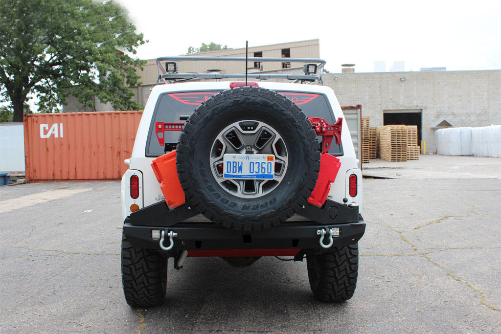

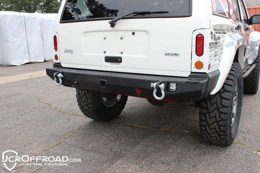

Next up- Ditching the C4X4 rear carrier and going for the JCR adventure.
It'll be a shit ton of money all said and done but-
-I'll be able to store 4 gallons of fuel- Good for the long drives we do here
-Higher clearance behind the tail lights
-LED light provisions
-They said I can get the tire mount 5 on 5, from the JK carrier for free, so I can bolt up my new wheels.
-It locks open, something I always wish mine had
-Saving clearance from the integrated hitch
So my 255/85/16 KM2's and moabs will be up for sale shortly!

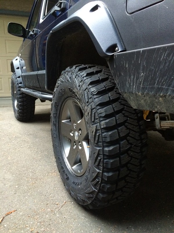

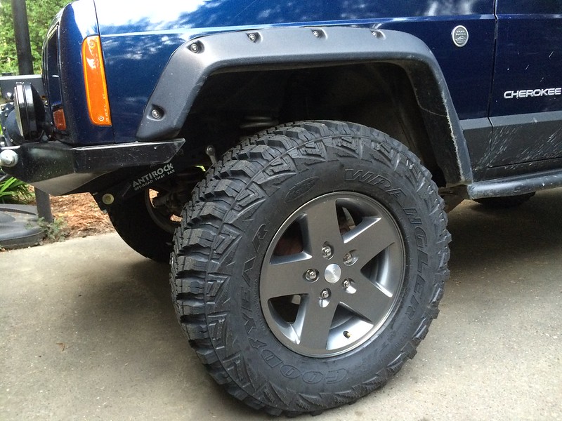

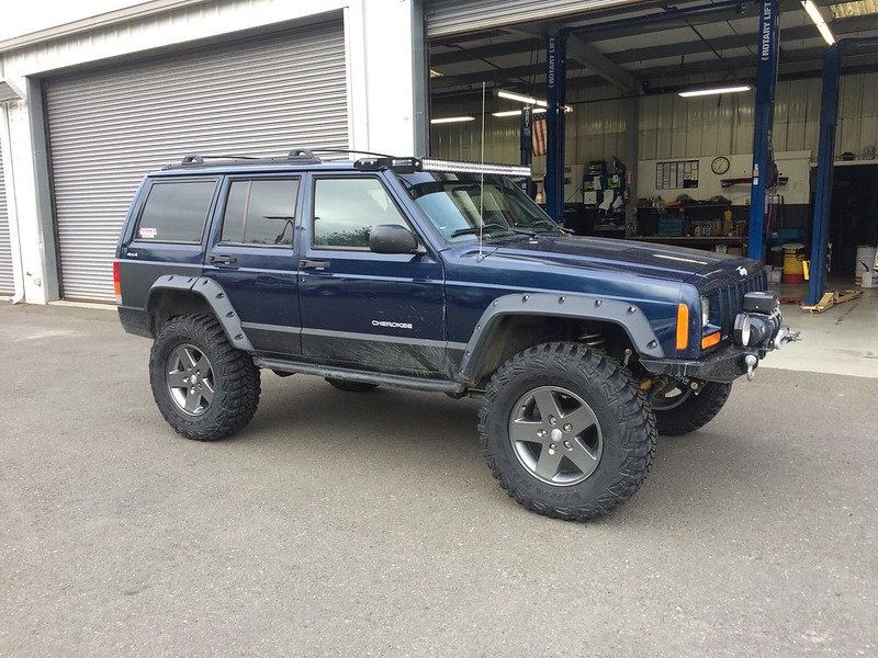

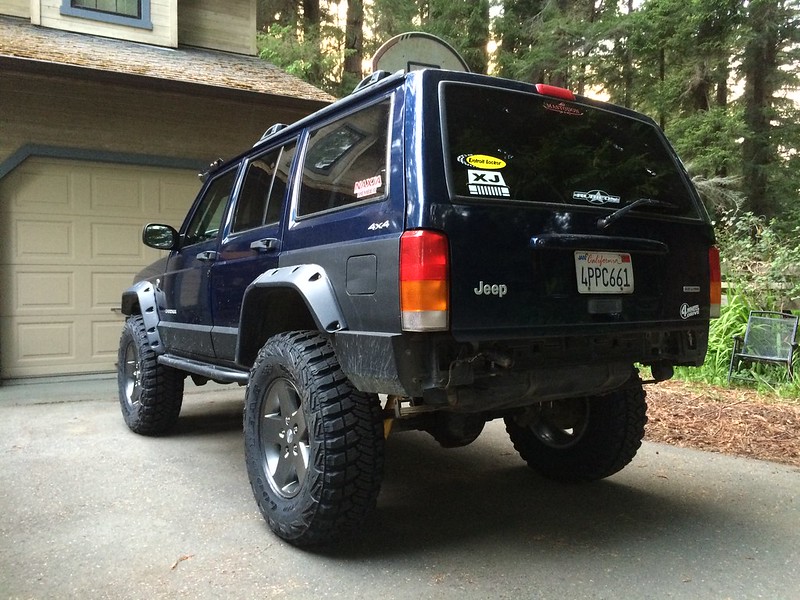

The new meats are on!
Super happy with these tires. They seem to ride a bit softer than my old e rated KM2's.
The size is 285/70/17, and I got 5. You can see also that my rear bumper is now off, I am ordering the new JCR setup very soon. The spare is barely squeezing into my trunk right now.
New shoes by Sean Mitchell 707, on Flickr

I ordered the JCR Vanguard last night. Holding off until I sell my tires to order the tire carrier portion. Holy hell is my wallet lighter.
It will look pretty damn good even just with the bumper. I ordered the side plates, and the whole thing powder coated.
Considering the weight of my last bumper, the carrier, and the hitch... I'm pretty sure I will be saving weight. The JCR set up is listed as 75 for the bumper, 75 for the carrier. So even at 150 lbs, that is likely 50-60 pounds less.

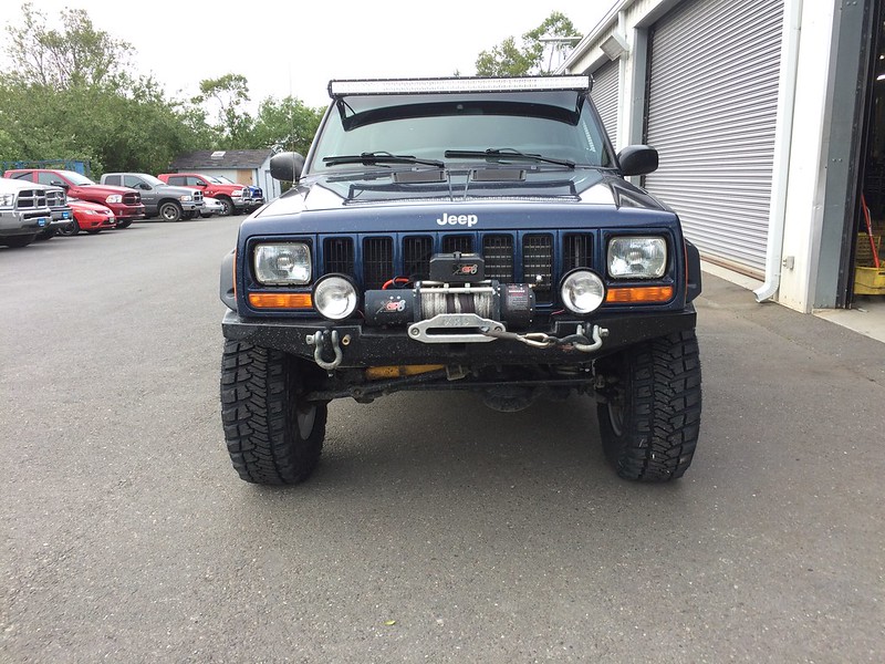

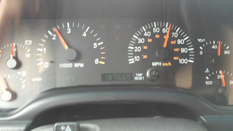

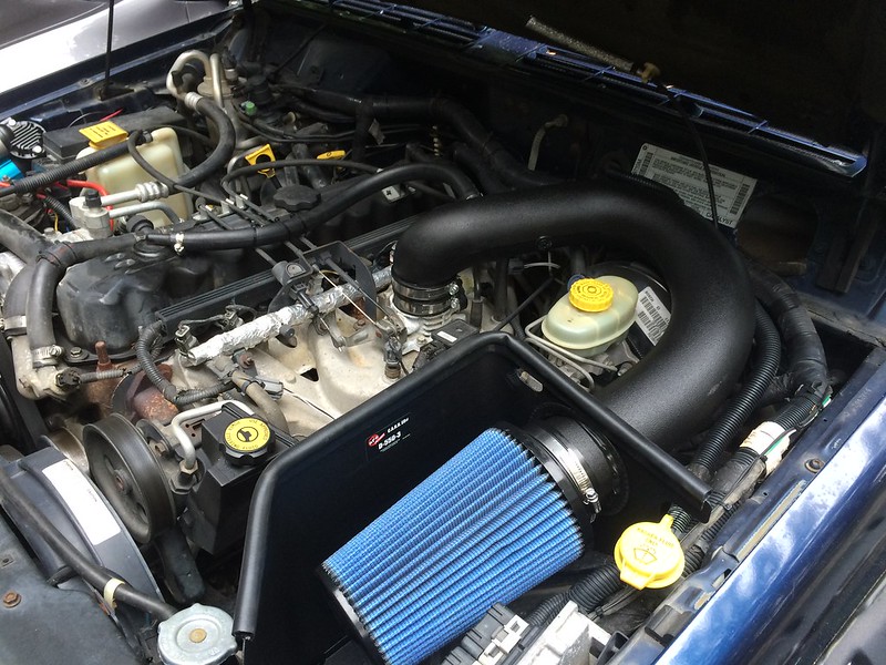

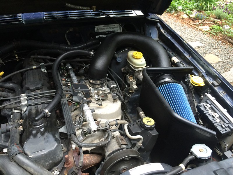

So in my quest to make my bluejunk a bit better for longer trips, highway travel etc, I decided to go for the AFE Stage 2 intake. Holy shit, I am impressed.
I see a ton of these at work. As always, the quality is excellent and the fit was perfect.
While I enjoyed the peace of mind that my cowl snorkel provided, it just hasn't been necessary. I think the ABS tube was probably a bit of a restriction coupled with the stock air box.
Here the new set up. I can't even believe how loud it is. It pulls much harder in the 3-4K rpm range. The sound of the air induction reminds me of the 4.7 in our Grand Cherokee. I am very, very happy. Should help me get this 4200 pound brick up to the 60mph range easier.
60mph - Better with decent speakers or headphones. Click this screenshot if you want to hear it
AFE Highway Pull by Sean Mitchell, on Flickr
AFE Intake for the Xj by Sean Mitchell, on Flickr

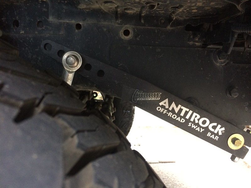

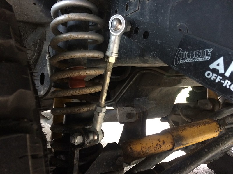

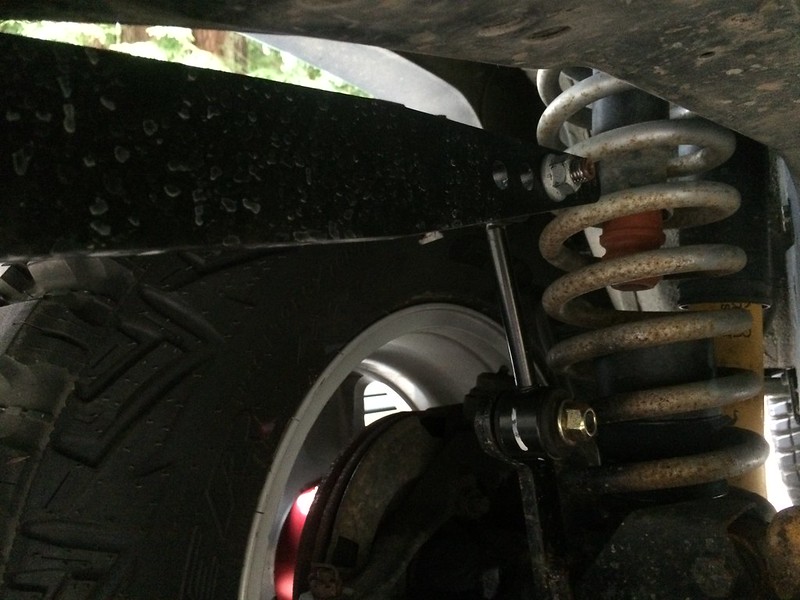

So I didn't post much about the Currie Anti-rock. It is awesome. Worth the 500 bucks. Much more stable in corners and no apparent reduction in usable flex.

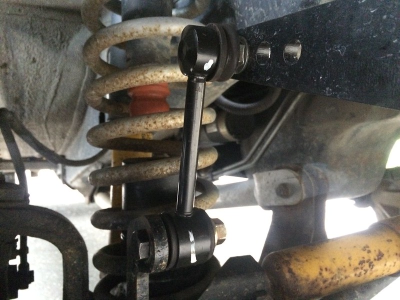

However, it probably isn't supposed to be used on a shorter setup like mine. I have 3.5 inch RE coils with no spacers, and a winch up front. The endlinks they supply use a heim on each end, but they are left and right hand threaded onto a 6.5 inch link. This is way too long. Even at the shortest adjustment, the bar was way above level for me.
I thought it was just because I changed my bumpstops that I was getting a clunk, nope. The bar was hitting the inner fender. My option was either to cut and weld the link, or find a replacement.
I did some digging, and observations while at work. Turns out front sway bar links from a new JK are the perfect size. And since we lift lots of jeeps, we had some laying around. (I have 2 spares too.) The lower side is a bushing and the upper is a joint, so it shouldn't inhibit any travel. This is good news for anyone wanting to run an anti-rock at a lower lift like my friend Dillon (dfulks on NAXJA.)
And best of all... This was free.
Before-
Extreme angle.
Currie Antirock Mod by Sean Mitchell, on Flickr
After-
