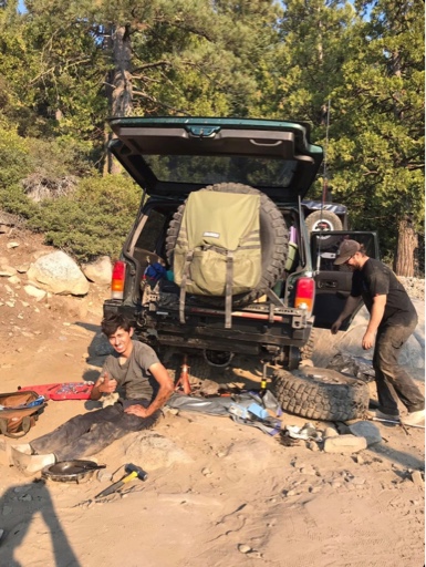

Got the truck to a safe spot to work where people can pass, thanks to fellow with a very well built tj. There I swapped my spider gears back in and continued onward with an open rear axle.

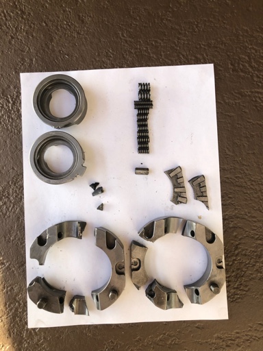

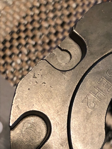

Had some damage to my brand new 4.88 g2 gears. Chipped ring gear teeth and pinion teeth with a spot that binds and knocks on deceleration. Locker is obliterated
