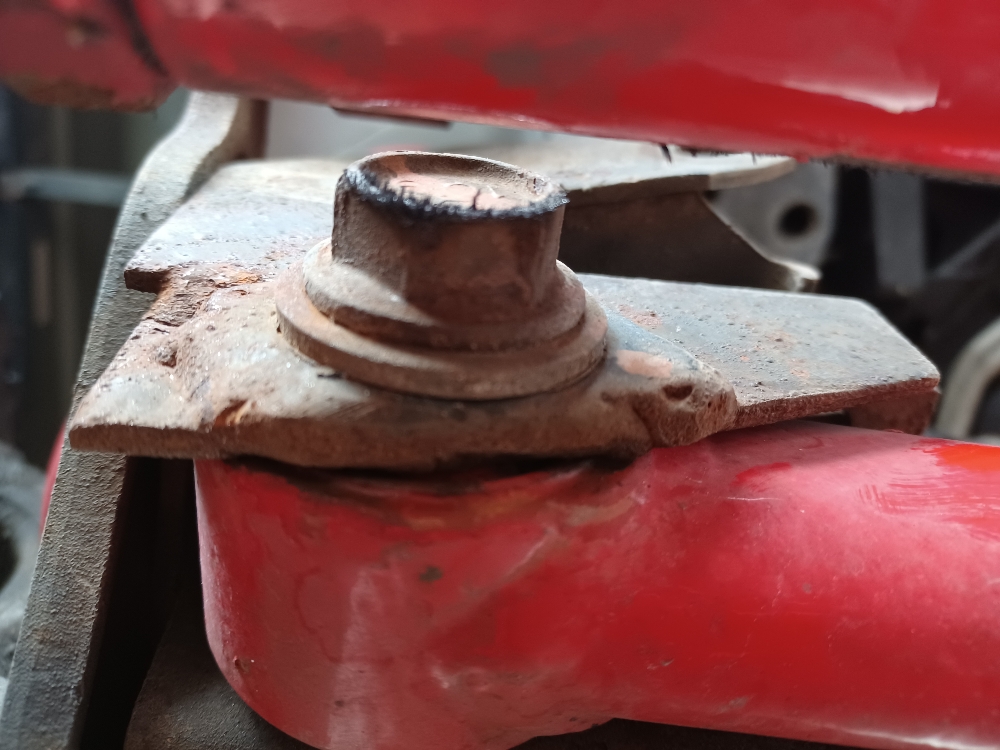

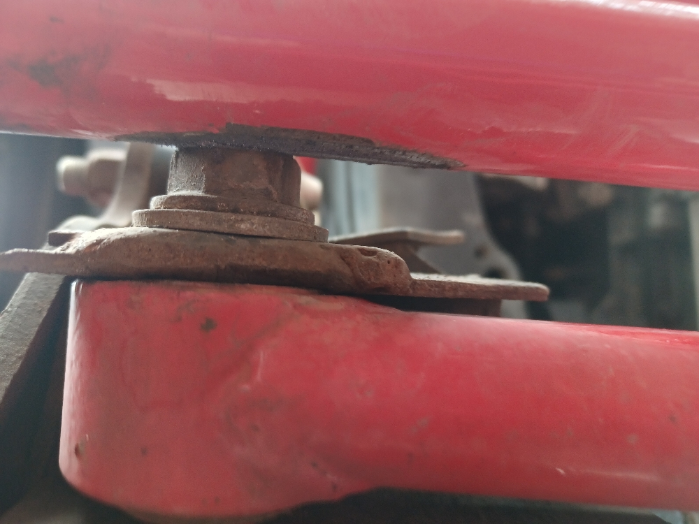

So my 2000 with 3" lift has an issue with hole for the track bar being ovaled. I brought it to a shop for an alingment after installing an UTK kit from JRC and they noticed the hole. they welded a washer on to fix it but now it sticks so far out that the head of the bolt now hits my 1ton UTK steering linkage.
I am thinking of getting the stinky fab mount and just swapping it out. But i have 2 questions.
1) is this the best solution?
2) what is the deal of track bar lowering kits for the axel side? Wouldn't that just make any issues worse? Wouldnt you want to raise it on the axel side? Since i have to fix this side should i be doing this?
