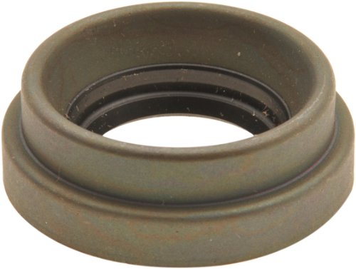

So I installed a Detroit Trutrac up front on my HP D30 axle along with chromoly 1 piece axle shafts (eliminating the disco axle shafts on my '87 XJ). I thought the correct seal would be in the kit I got to seal the pass. side axle shaft but it wasn't. And as most of you know the disco axles are not machined for a seal. I sanded the axle shaft and put a new seal in the stock disco location (near where the shift fork was). It lasted about 2 days and now I get some drips every now and then. I want to tear it all apart and reseal it properly (especially since I will be taking it to the sand in a couple of weeks). Anyone know the part numbers for the seal that I need? I did a search and came up with way to much contradicting info.
The numbers that I have been led to believe will work are:
Napa CR11800
Napa CR11343
National 471763
Can anyone verify this? I would like to have everything on hand so I can bang it out in a couple of hours without having the diff torn apart. Thanks.
