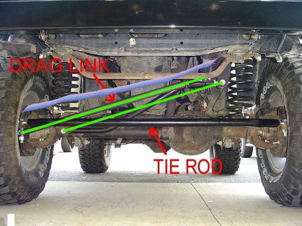

Got the new re1660 track at installed and I still have deathwobble. It is much less severe now and I can drive a little faster. The track bar also made when front end feel much tighter.
Don’t know where to go from here other than to just start replacing everything. When I bump the drag link there is a slight bit of noise but I can’t exactly tell where it’s coming from. Maybe I drilled out the pitman arm too much or maybe the gear box needs to be replaced? I guess I’ll slowly buy all new steering components
