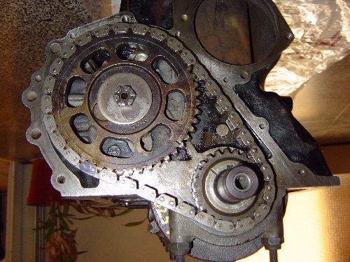

If you put a straight edge through the center of the cam & crank sprockets, it should also go through both dots like in the pic below. If not, you'll need to realign them.
Got everything allign, used the degree wheel and a piston stop method and it worked out fine. The harmonic bal. must have split, it was almost 1/2 in off from the TDC mark.
The only concern I have now is that from idle to 2000 rpms is sluggish or it bogs. As itsoon as give it gas it nose dives or hesitates then it takes off. Feels like a lean condition. Maybe the big valve head, cam, 63mm tb and CAI have something to do with it?
Dont know about degrees, I used the wheel to measure TDC with the piston stop. Exact middle between the two stops. I wich I had taken some pics. I have read all over different forums and I guess the 96 to 98 xjs can be a pain set the timing just right. Im sure my timing is still little off, but that can make big difference specially with a new Cam.
