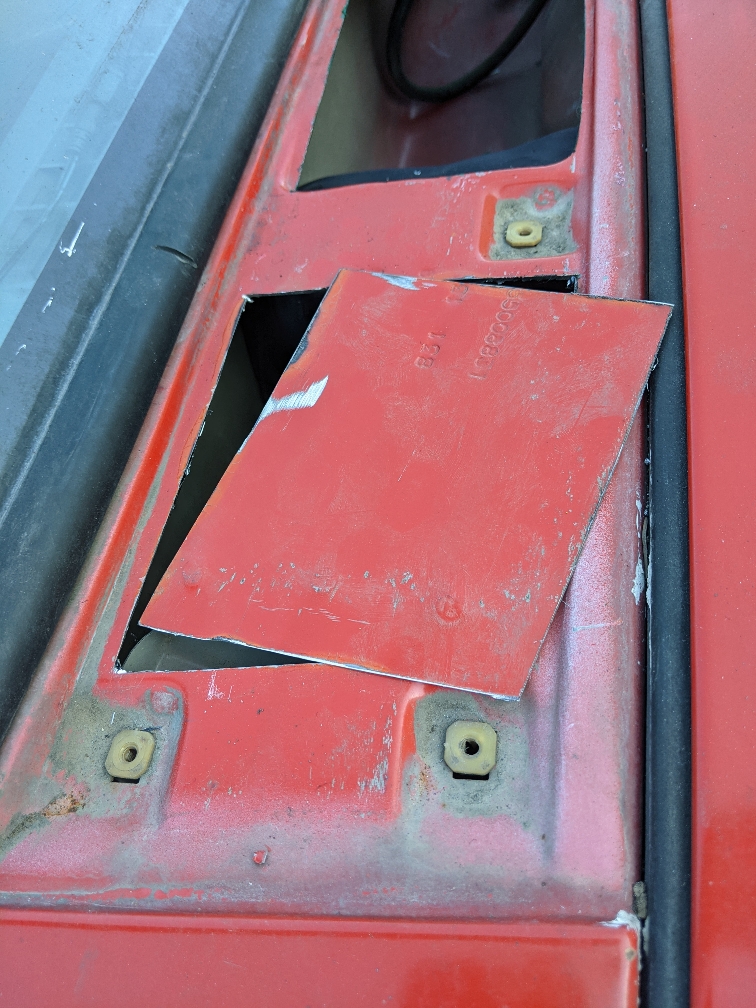

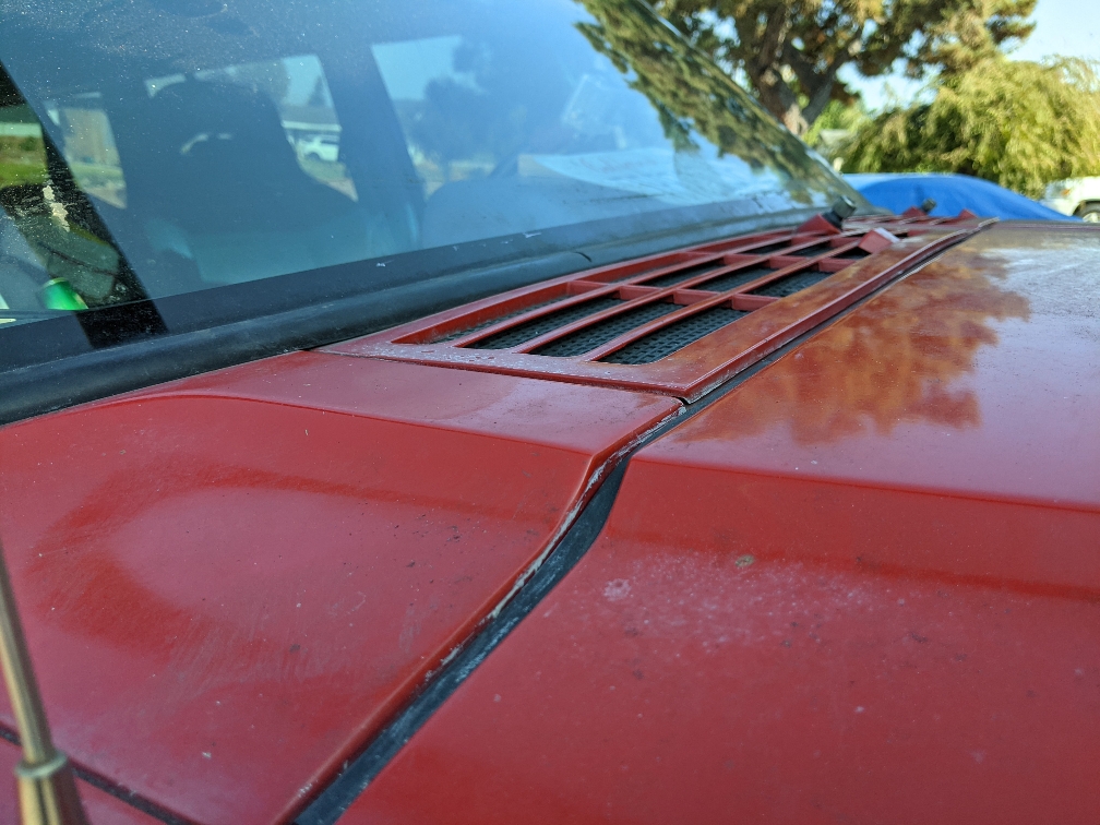

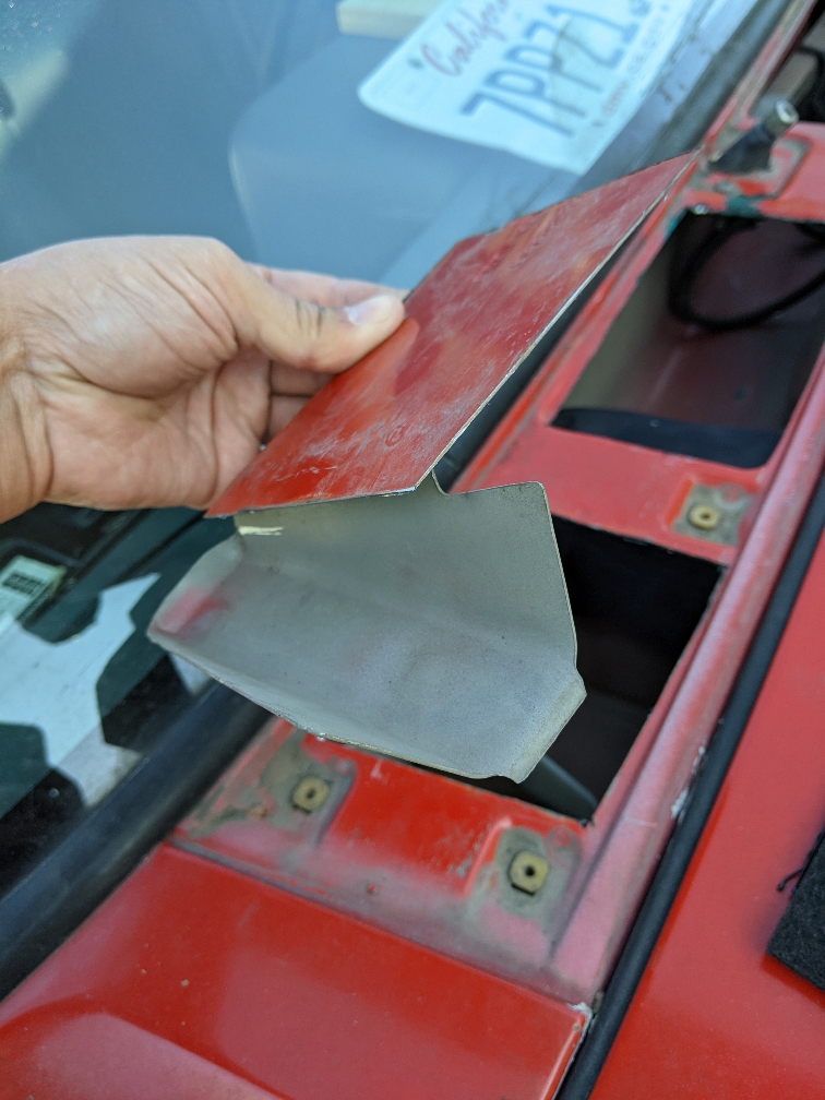

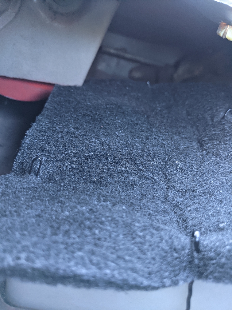

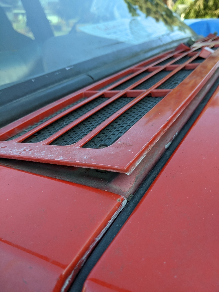

So this is v1 but I finally took the cutting wheel to the cowl for a cold air intake and decided to do a cabin air filter mod at the same time. I have bad allergies and so I needed something. With some Bobby pins and a sheet of carbon pre filter I've got something that should catch a bunch of stuff. You should note that I tried to waterproof the cut opening so the filter wouldn't get wet.
