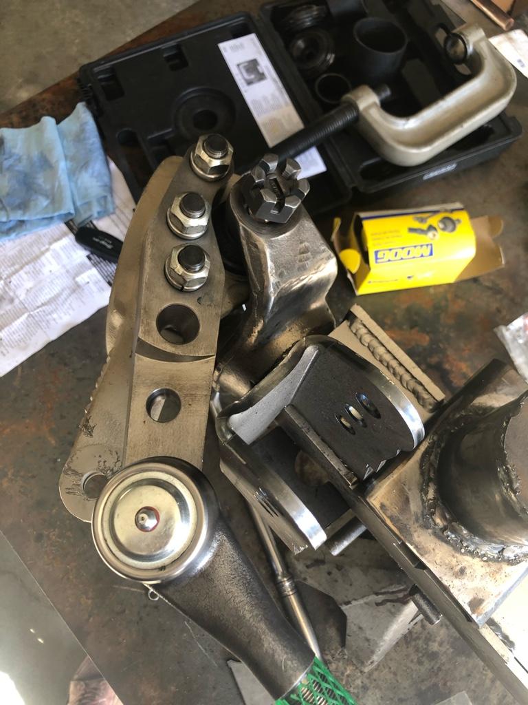

One thing I’m thinking of is clearance between that track bar bracket and your drag link at full lock. Are you reusing stock knuckles? Maybe loosely mock the passenger side knuckle up and see if there will be obvious interference issues at full lock.
Sounds good, I’ll try that next time I get a chance to work on them.

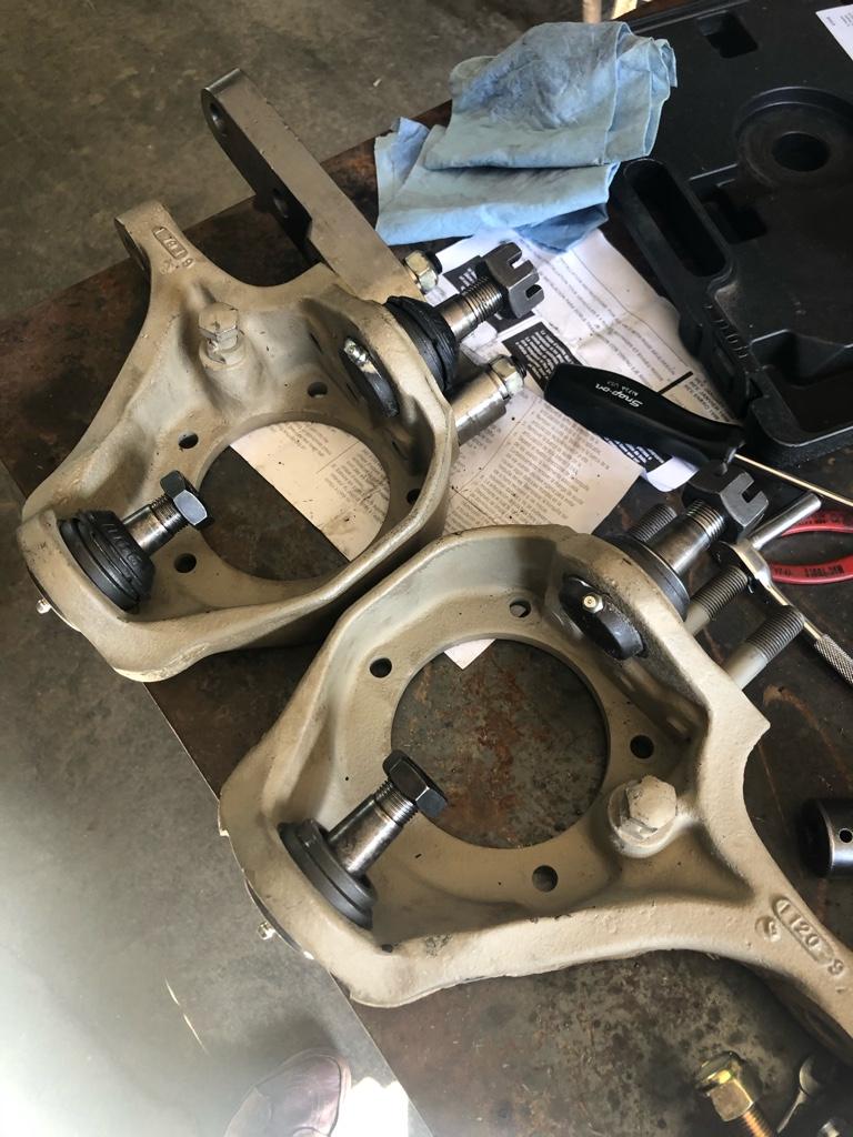

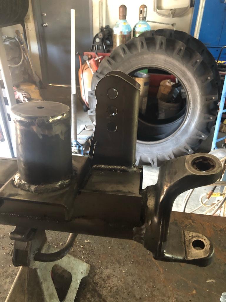

Got the ball joints in the knuckles today and see how things would fit. Happy to say that the track bar bracket will fit outside the spring perch without the steering coming in contact. It’s a bit of a tight fit but it will do. Got the TB bracket and both spring perches burned in too.
Thank you both! It’s slow going but it’s a lot of fun. Need to add upper/lower control arm brackets and shock mounts then I think I’ll be pretty close to done with the front axle.

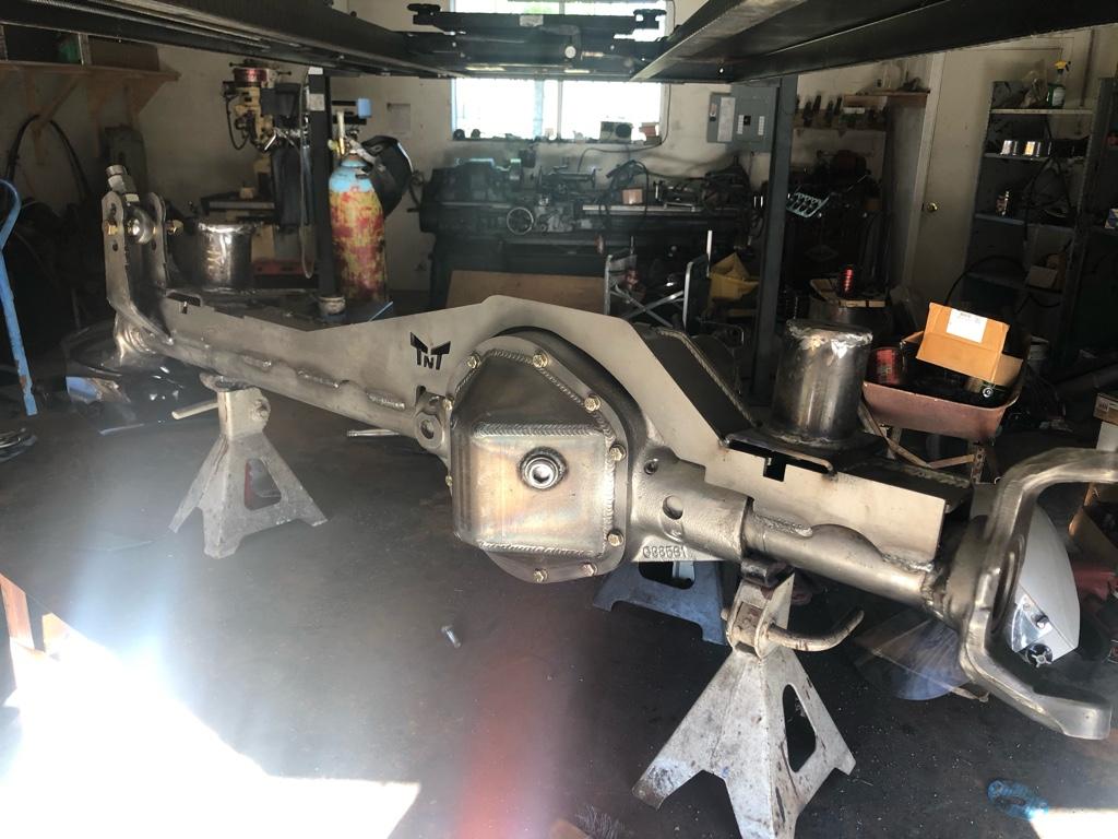

For those of you who have done leaf spring mounts on a clean axle, any advice on getting pinion axle right and keeping the spring mounts square?
Maybe I missed it, but which track bar mount is that?
When I did my rear swap I just bolted everything together pretty snug, put the Jeep on its own weight, and rotated the pinion up with the jack until I was satisfied. Tack in place, remove, and burn it home.
This. Just make sure the axle is centered and everything is where you want it to be before tacking the spring perches in place.
This but I probably would not even pull the axle back out. Tack both sides of each perch, pull a u-bolt, burn it in, re-bolt, repeat.
Thank you all for the great advice, I was hoping I could get everything welded on before I tear the Jeep apart haha, guess not. But doing things the right way is worth the extra time/wait.
I mean they don’t fit them up under the car at the factory so it can definitely be done on the bench. As long as you are happy with your existing pinion angle or know where your happy spot will be, and can measure the corresponding spring perch angle (it might not be exactly level), some careful measurements off the backing plates to get the perches evenly spaced and the right distance apart.
I took a measurement off the rear driveline and got 12 degrees. I was thinking if I put the pinion at 12 degrees on the ‘new’ axle and put the spring perches level that would do it. But after thinking about what you said, if I did the same but matched the angle of the current spring perches it would work pretty well. And I would make sure the perches would be spaced correctly L/R.
