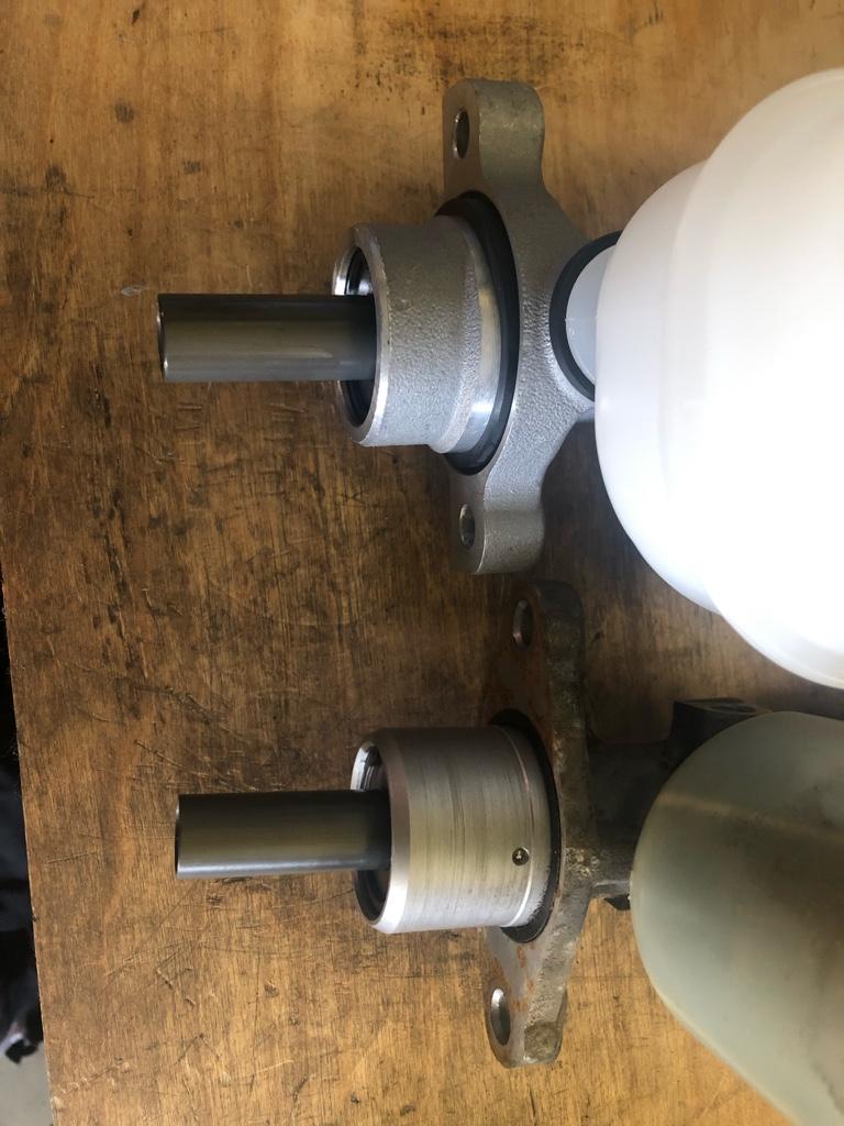

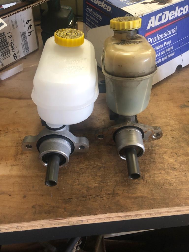

Ordered the centric 131.67025 Mc but it doesn’t fit with my WJ booster. The two bolts don’t line up and the part of the MC that seats into the booster is too large to seat correctly.
@nate did you have to modify your MC to make it fit with your booster? Has anyone who has done this kind of swap had any issues like this?
Thanks in advance!
