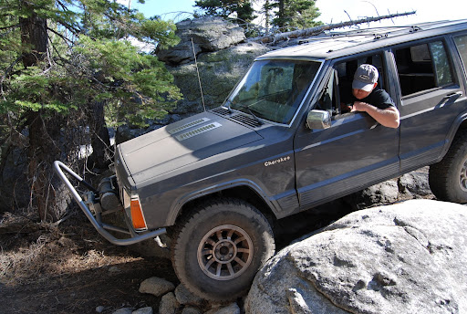

This might be a little dated since the last post was Aug 2010, but a couple of weeks ago I installed the Runcool hood louvers on my XJ (I don't have pictures, but if you look on page 1 at Sunburned's XJ, mine is identical and looks like we have them installed in the same place).
