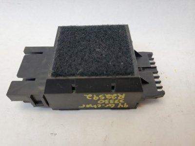

Look under the dash, below the steering column. You should find a small black box velcro'd to the lower dash panel. That's the intermittent wiper module. Of course, unless it's not there. The module simply connects between the 2 connectors. If it goes bad, folks simply remove it and plug the 2 connectors together so the wipers work but only in "fixed" mode.
