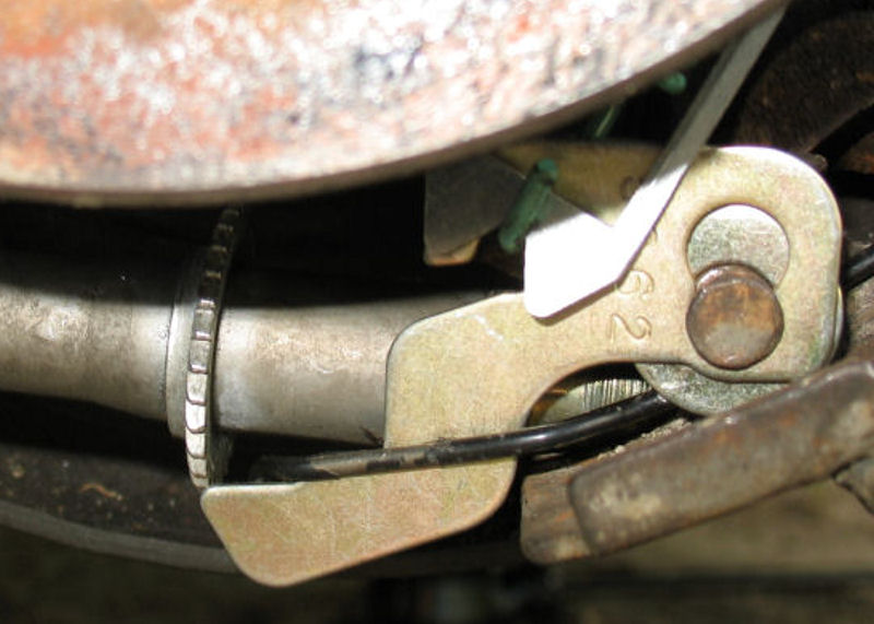

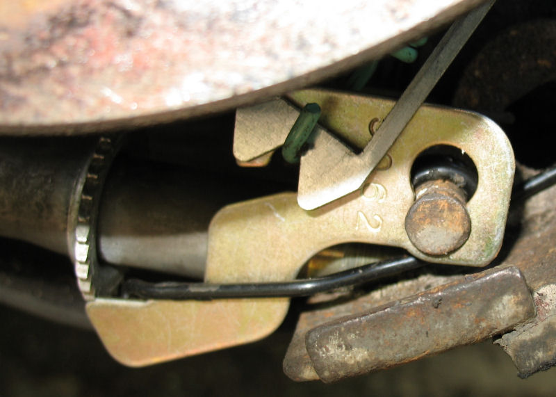

Yeah it helps. Here is the stock setup, you can see that the spring has a little bit of room between the lever and the backing.
Since the purpose of the spring is to hold the lever inwards, allowing the spring to move out allows the lever to flop around and disengage from the sprocket.
By putting an M8 washer between the spring and the lever, the spring is pushed back against the backing, which in turn causes the far end of the spring to pull the lever inwards so that it stays engaged on the sprocket
