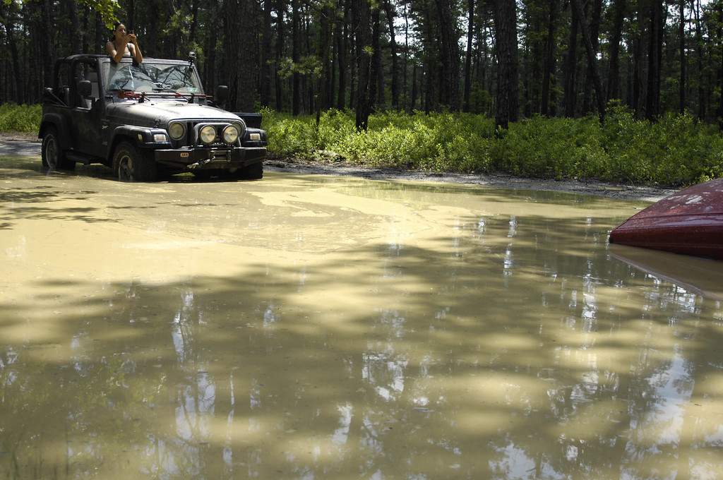

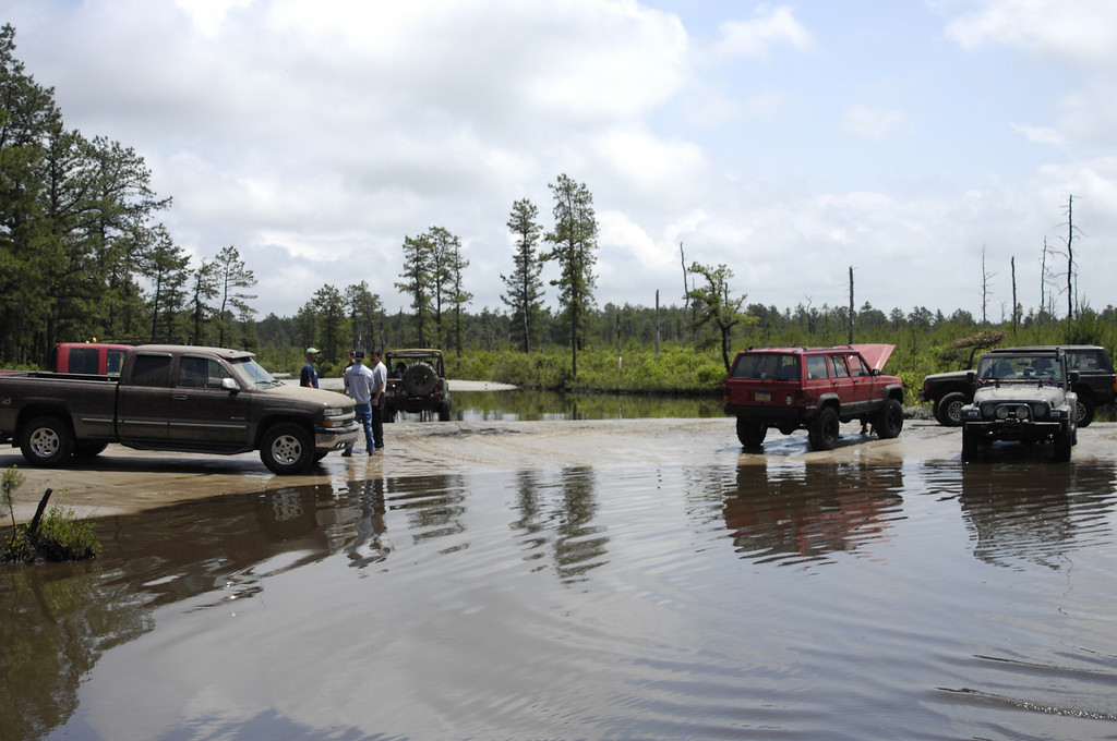

So this was a spur of the moment trip. It was only going to be myself and another buddy or two, but we ended up with 3 XJ's and 2 TJ's (Mine included). We met at the Atsion Ranger Station off of Route 206 and headed back to the "1/4 Mile" as it's called. A lot of guys with massive full size trucks and Duece and a Half's come through the area often and tear it up. Some of the ruts in this area can easily put a lifted TJ on 35's under water over the hood. We typically avoid this area for actual wheeling, but we do check it out on our way through the forest.
Some of the holes, note the dark water - can't see the depth at all:
http://pafirefighter11.smugmug.com/gallery/8563275_bCVKr#564167055_35W2h-A-LB

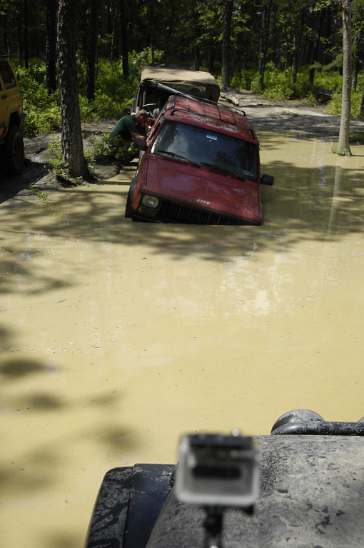

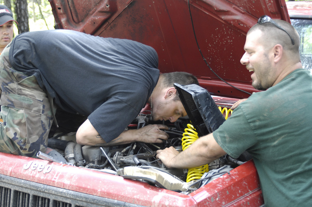

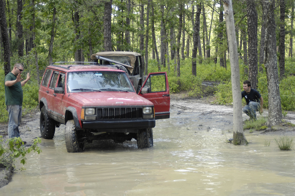

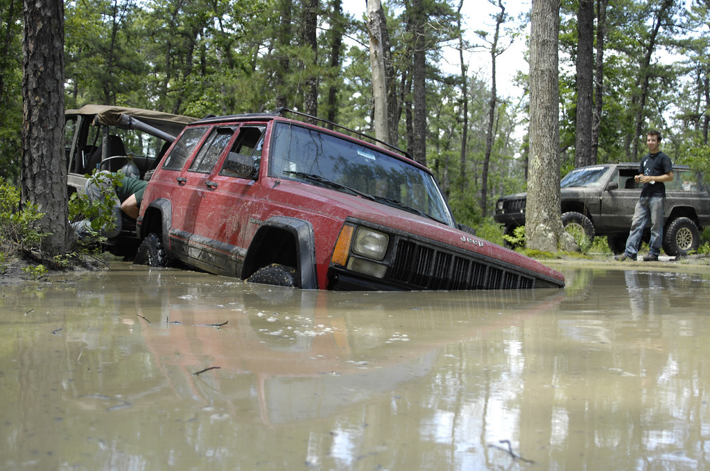

We hung out there for a few mins, tried some of the holes, realized that the recent rains really brought the water level up, and eventually left the area fearing hydro-lock. One of the XJ's sunk pretty deep and took water into his airbox:
Video:
http://pafirefighter11.smugmug.com/gallery/8563275_bCVKr#564146040_MdGYc-A-LB

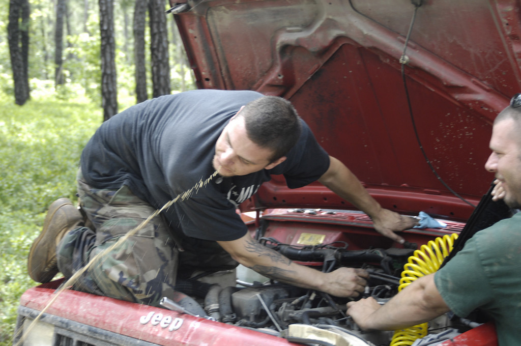

The water was then sucked into the engine. Fearing hydro-lock, we pulled the plugs, filter, throttle
body, etc. There was water pooled in the throttle body pretty bad. A straw and siphon method was used at first, but then rags were being used:
Video:
http://pafirefighter11.smugmug.com/gallery/8563275_bCVKr#564147229_y4c2C-A-LB
There was also water in all 6 cylinders. PB Blaster was used inside the cylinders and we cranked over the engine for a few minutes while water was jettisoned out of each cylinder, mainly the #1 cylinder. After about 1.5 hours he was good to go.

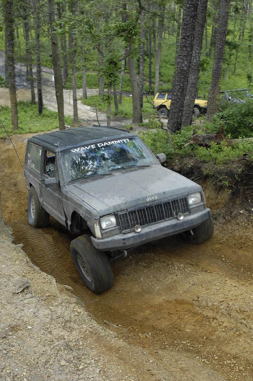

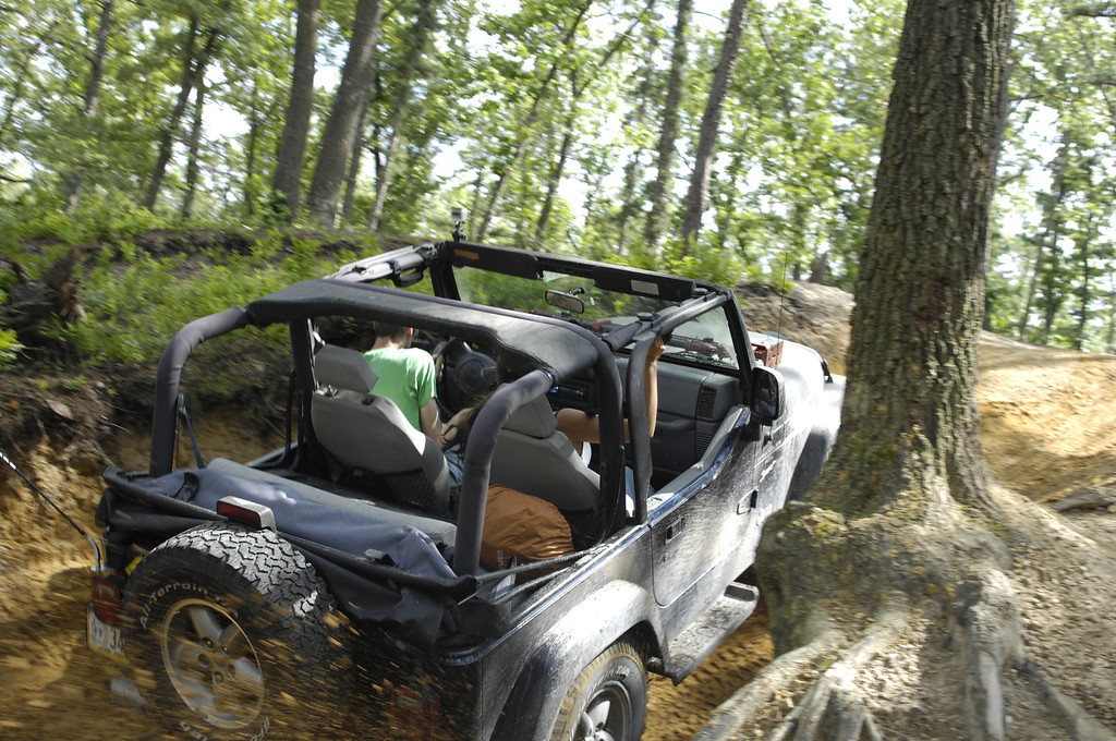

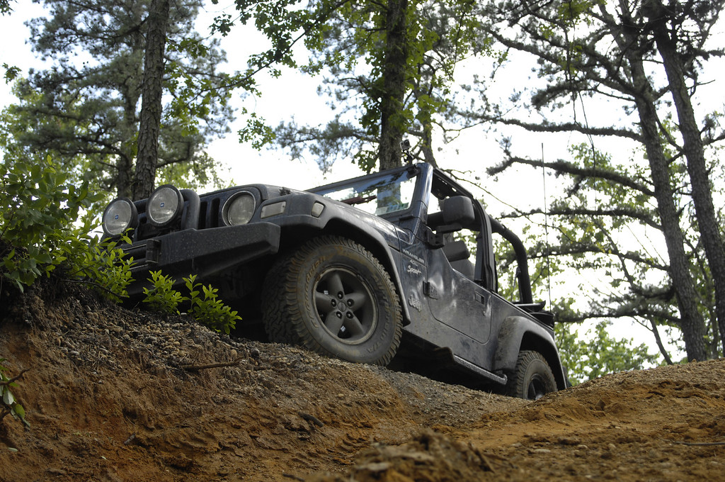

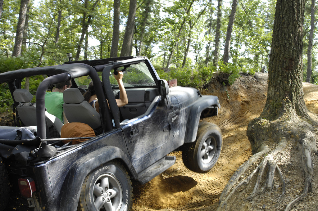

We made our way to a hill climb and grabbed some photos and video's. The shots of me driving my blue TJ were taken with my camera by my friend Tom with the green XJ:
TJ almost flipping:
http://pafirefighter11.smugmug.com/gallery/8563275_bCVKr#564135536_Ztveg-A-LB

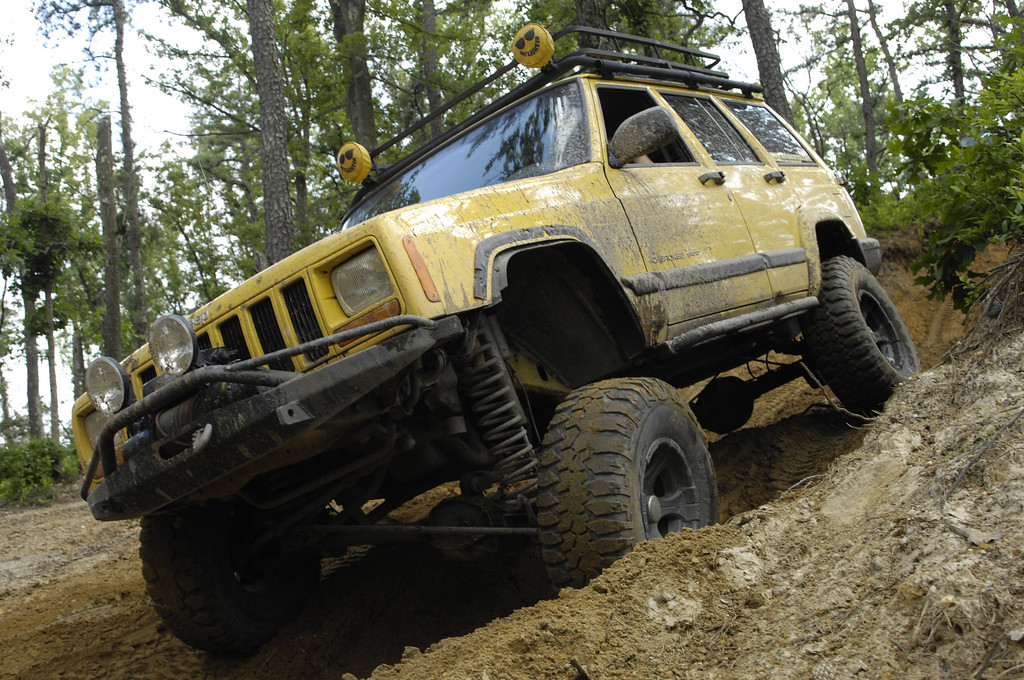

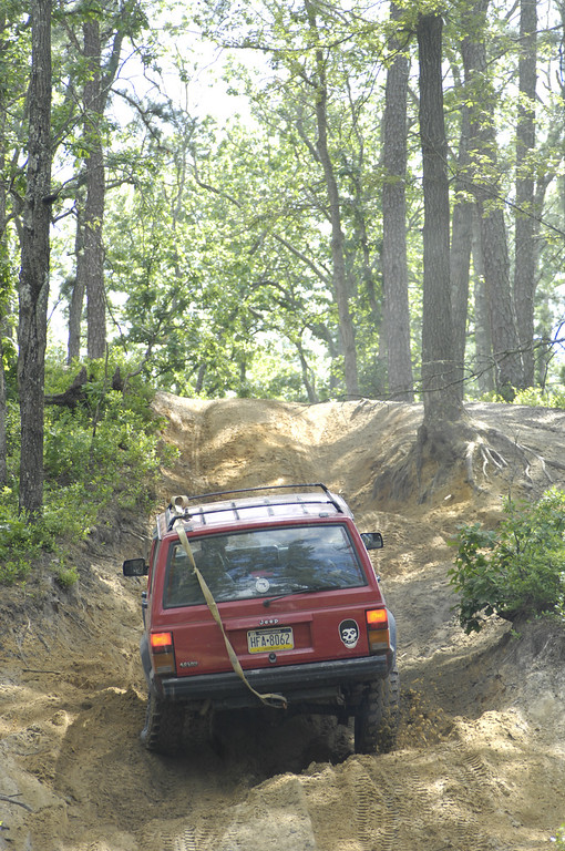

XJ climbing:
http://pafirefighter11.smugmug.com/gallery/8563275_bCVKr#564157352_3fRw7-A-LB

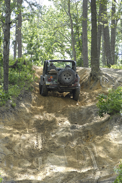

My stocker TJ making the climb:
http://pafirefighter11.smugmug.com/gallery/8563275_bCVKr#564153436_uRePZ-A-LB

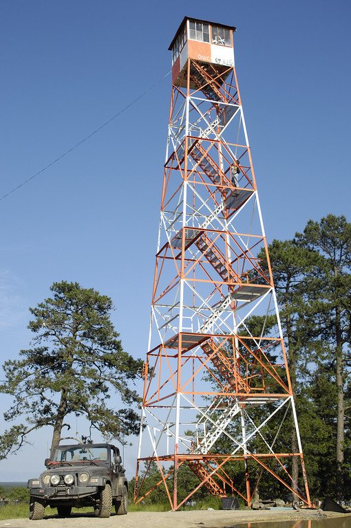

2 XJ's and the other TJ then decided to head out. Myself, my passenger, and my buddy Tom in his XJ decided to go to Apple Pie Hill and the Fire Tower. We cruised out that way and arrived about an hour later:
http://pafirefighter11.smugmug.com/gallery/8563275_bCVKr#564161702_yjfJ5-A-LB
This is a fairly tall fire tower where idiots enjoy dropping items off the top to see what happens when they hit the ground. Anywho, here are some photos of that:

Start the clock...based on typical 4.0 experience, it'll throw a rod within a week. :D

In that first hole, I hydro'd my motor last April. Cracked the piston around the edges (the guides that keep it level in the cylinder). It never broke off completely, but started taping badly about 9 months later.
the main problem for the red XJ in our group last week was that his intake manifold filled with water. The cylinders didn't have very much in them, but there was a lot of water left in the intake that wouldn't go into the engine. That's when the straw and rags came into play.

Could be right about the rod.
Some hard core guys do an oil change in the woods after cleaning the water out of the cylinders.
The clue is the dip stick has muddy water on it and the level is higher than normal.
