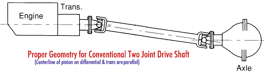

You did a 3.5+ with out a transfer case drop? That is probably why........ Late model XJ's are more prone to vibration anyways. I have 5" in the rear and 4" in the front and got a little bit of vibs before dropping the T-Case.
Look up proper drive line angles on interwebby for a diagrams or here is one;
Pic
Standard 2 joint shaft Driveline angle
.....................you will see the output on the T-case and the pinion have to have a parallel line. If you look at yours by just glancing you can see if you are off or take a level and hold it up to get a quick eye on it.

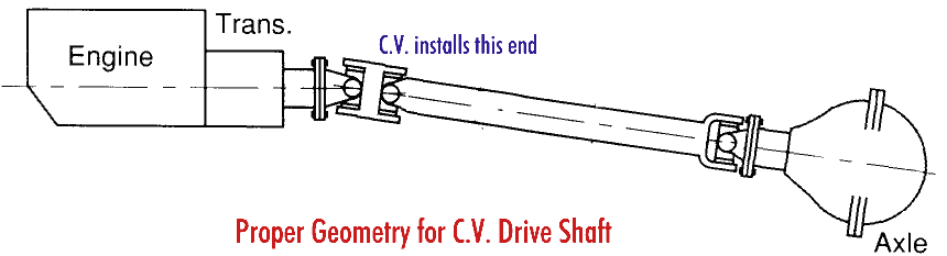

Now if you had a CV shaft then the pinion needs to point straight at the output on the T-Case.
Like this;
CV style driveshaft SYE angle
Like this;

Your front does have a CV style shaft but odds for vibes are on the rear which if you have never none a SYE kit then you have the wonderfull standard 2 joint shaft and for that look at your rear shaft and draw and imaginary line from your axle to the t-case, it should match that first pic I posted. A lot of times when you put on a brand new lift it acutally nets you higher lift so you probably have 5" of lift right now. Check your angles and drive it allowing the springs to settle and that will help as well.
Most likely a simple t-case drop will eliminate any vibes, but for good measure look for play in your u-joints and grease em up good as Hypoid suggested.
