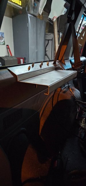

Well it was an interesting voyage to say the least but here's what I came up with. I purchased the seven switch center dash panel. I added a CB radio and a GMRS/HAM radio plus a lighted CB whip. Replaced the center console brace with a metal one. I also mounted the compressor, tank, water separator, regulator and ARB solenoid. Let's here what you think.

I finally got some pictures. Sorry fir the delay
