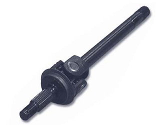

Also, off the jeepin.com mainpage you can hit the link to shop for new parts. What may be an option for you is to buy complete new axleshafts assemblys with new Ujoints already installed. About 115 each side shipped, and plus you can keep your old ones as spares.
Thanks for the link. Muchly appreciated. No in my budget to replace the axleshafts right now with a couple other things to be done first, but something that is good to keep in mind. Will check them out.
