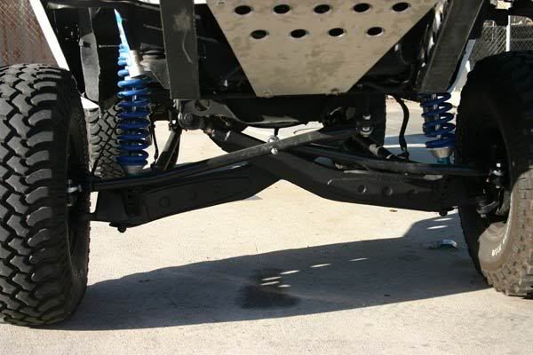

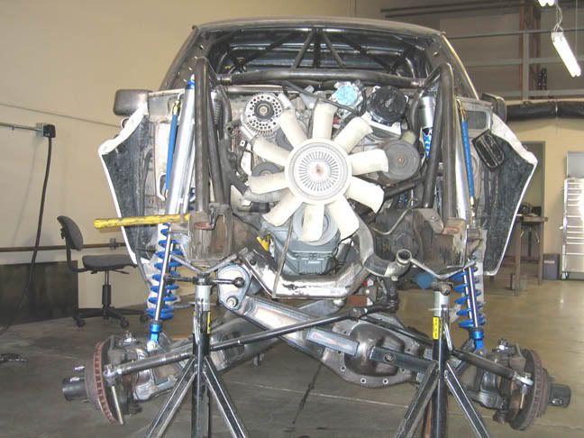

The pics Jason posted are a good example. If you compare the stock beams with the ones on the coil over rig you can see the changes they made. If you have much lift it may require a complete redesign of the the stock beam.
I have seen a few companies that sell aftermarket 4x beam with some redesign already done, maybe they would work.

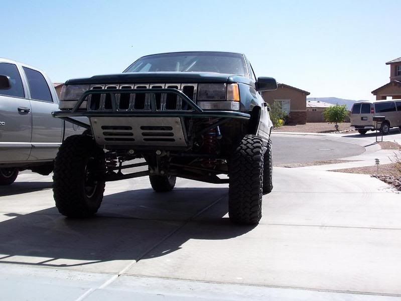

yea those are not mine just got the pictures off the web the first pic just to show a nicely done ttb setup the second one is center mounted a arm on a grand 2wd but impressive the ground hawgs were the only tires i had with the right wheel close to a 37" tire wore down 40''s i was just pondering things to see how it all measured up put the 30 back under it to make some long arms then i might find a ranger ttb to see how it fits
While the fab work on that TTB is incredible, the STOCK steering is really not cool. Think really bad bump steer at high speeds... That TTB setup needs a complete crossover steering, but not like the solid axle guys. The desert guys use an extra pivot opposite the steering box and by the steering box, and links running between the pitman arma and the oppsite pivot, from the opposite pivot to the drivers side steering knuckle and the pivot by the steering box, then from that pivot to the pass. side steering knuckle. The pivots match the mounting locations for the AXLE pivots so geometry remains the same throughout suspension travel. Meaning, NO bump steer at desert racing speeds. But expect for a shop to have your truck for weeks and to spend $3500 and up...

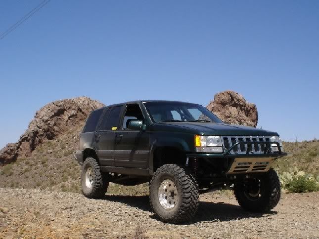

this is the only other picture of the grand i got if i can remember where i found it i w
ill look for more and this is the steering you are discribing i am still studying this ttb thing but i have learned the steering setup is different for equal leangth pictured here and unequal leangth as the ttb picture
my bad that is not the setup you were talking about i cant find the right pic or do anything else right so i will try again later
