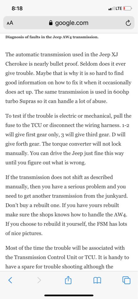

Update. I just unplugged the TCU and attempted to shift it manually. 1/2 only gets me 1st no shift to 2nd, manually shift to 3rd, then attempted to shift to D. It does the exact same thing with or without the TCU.
TCU fried maybe???
Is the throttle-body to trans cable adjusted correctly? If you're not getting 4th gear with the TCU unplugged and the shifter in (D), then it's a mechanical issue. Possibly an error made during the rebuild?

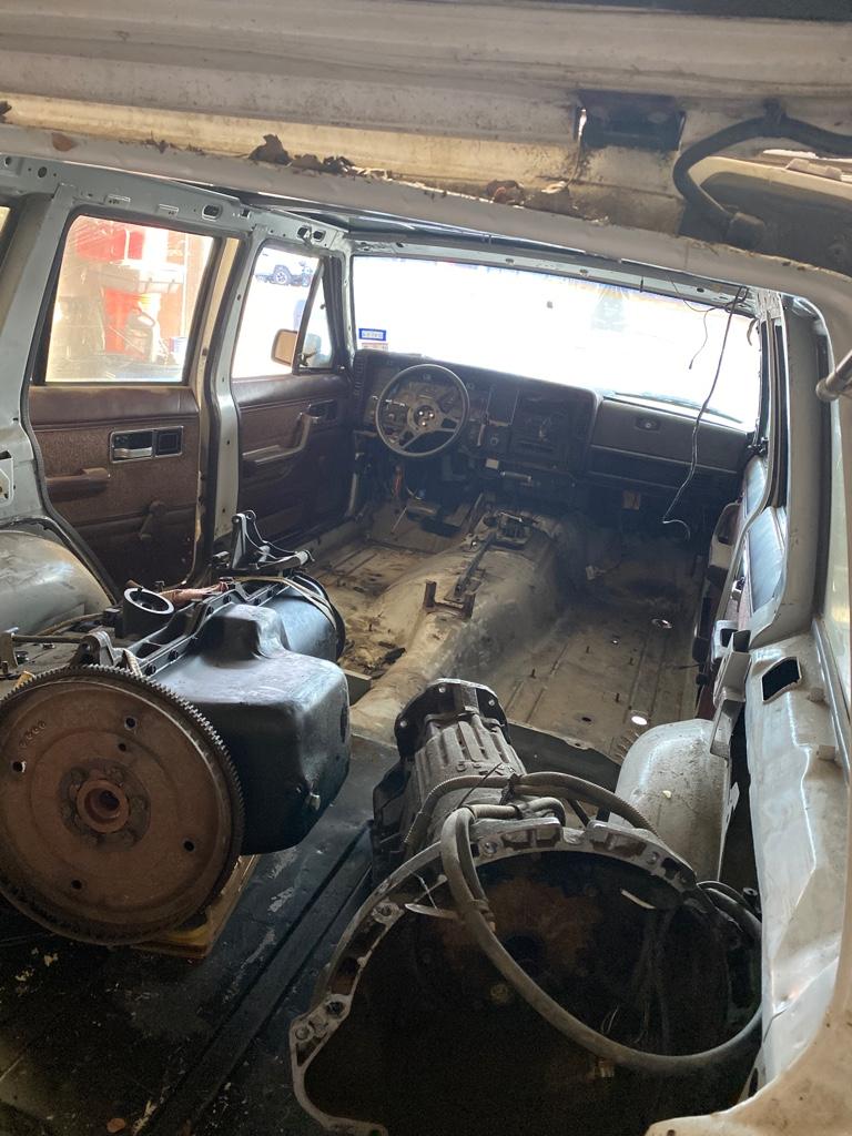

Funny I just found a read last night about just exactly that. Well S**T.. My buddy took it upon himself to rebuild the trans, by no means a mechanic but I had full confidence he did a good job. He had a good manual and had a BUT load of pictures as he took everything apart, was very organized. I certainly wouldn’t have attempted this. He said it drove fine with no issues once he got it all back together and see no reason for him to lie about that. Have no idea what could have happened. Very frustrating!
Fortunately, I still have the original motor and transmission that were both in good working order when pulled. Looks like this turned into a trans swap. Guess I’ll be yanking a trans this weekend. I’ll transfer all the new components/sensors from the “rebuilt” trans to the original.

Yeah, the trans cable just controls the hydraulic pressure, and thus shift firmness. Too far out of whack can cause overly-firm shifting or sloppy shifting or even not shifting at all. Sounds like you're binding up though.
The AW4 Service Manual isn't that helpful:
Condition:
- Drag or Bind on Upshift
Causes:
- Shift Linkage out of Adjustment
- Valve Body Faulty
- Transmission Faulty
Corrections:
- Adjust Linkage
- Repair Valve Body
- Disassemble and repair transmission
Yes, not much help at all lol
I talked to a transmission guy today. Going to take the truck to him Saturday and see what he thinks real quick.
I’ve read that rebukes in the transmissions don’t hold up as well as factory. Inferior parts I assume. I guess worst case I’ll throw the old one back in. Kinda like the idea of having a near zero mile Cherokee though!
Thanks for your input. I’ll post back results Incase it helps anyone else
