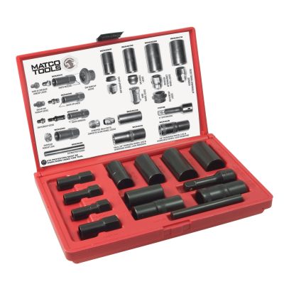

Napa sells a tool specifically for removing wheel locks. It's a socket that you hammer on... Works pretty good.

http://matcotools.com/Catalog/toolcatalog.jsp?cattype=T&cat=2424&page=3&#42894
