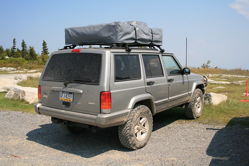

Cherokeejpn2 said:
Here is what i did and it worked out great!
Interesting. Got any more pics of your build?
