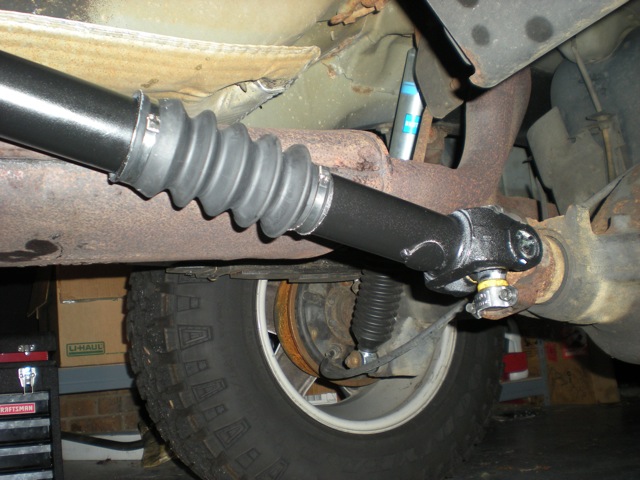

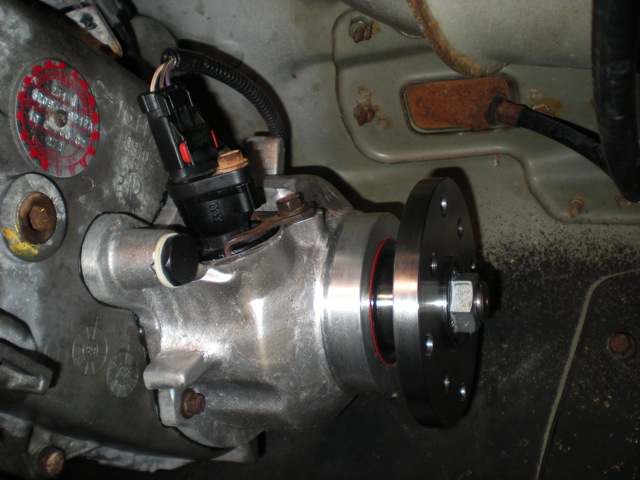

Managed to get the SYE installed over the course of about 12 hours (several trips to Sears and Harbor Freight were required because I'm a moron). Driveline vibrations are gone, except a very mild vibration when accelerating between 30 and 35 MPH (and a faint drone at 70+). Looks like I'll need to measure my driveshaft angles and see if I need to do some slight shimming.
Anyway, pics! I didn't document the whole process due to being somewhat pissed off the whole time, but I did snap a few pics.

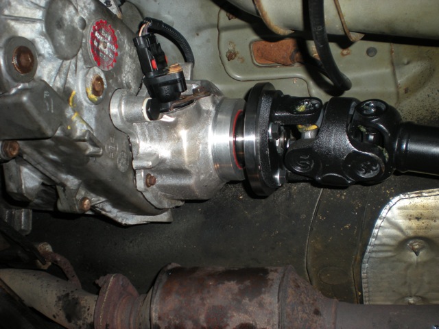

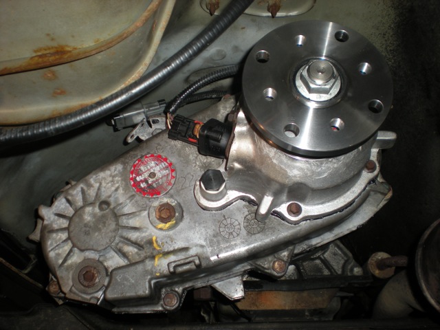

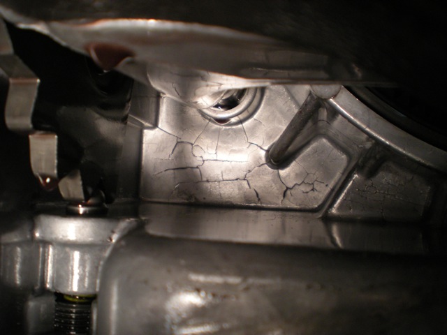

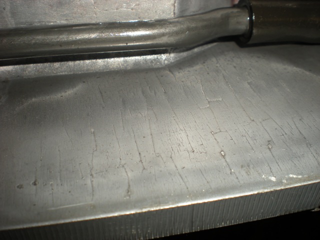

While I was doing the installation, I did find some hairline fractures in both the front and rear halves of the transfer case:
There were additional hairline fractures appearing in the original tailshaft housing as well... I did put quite a few miles on the vehicle with these driveline vibrations (probably nearly 1,000), so I'm glad I got this done before any kind of failure.
How likely is this to cause long-term problems? I'm dreading the prospect of needing to get a new transfer case and having to move all this stuff over, as the oil pump did anything but "slide" onto the new mainshaft like it should have. Even with the teeth lined up perfectly, I had to tap it on 1/10th of a millimeter at a time with a hammer and screwdriver (light tapping, as heavy hits did nothing to aid the process). Fortunately, once in place, I managed to get the oil pick-up line fully seated into the pump, and the pump still rotates freely.
Let me know what you guys think.
*EDIT* Another note - my 231 only took about 1.5 quarts of ATF+4. Everything I've read states it should have a capacity of 2 quarts. Is this normal?
Dont know what to tell you about the tcase... although i know that those fractures can lead to failure...

Thanks pyrotyro... I started a new thread on those and the general consensus seems to be that they're a result of the casting process and shouldn't be of any concern. I guess time will only tell - there are no leaks and everything seems to be working fine... for now :)

well thats good, i just instantly think of the jk tcase problems (my dad has a 4door and was way worried about that). the bumper should help some, getting some extra weight back there. just give it some time :cheers:

I, too, am worried by cracks in anything that aren't supposed to be there... Especially in a component as significant as the transfer case :) . I'm looking forward to receiving the bumper, so I'll definitely report the outcome.

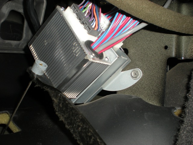

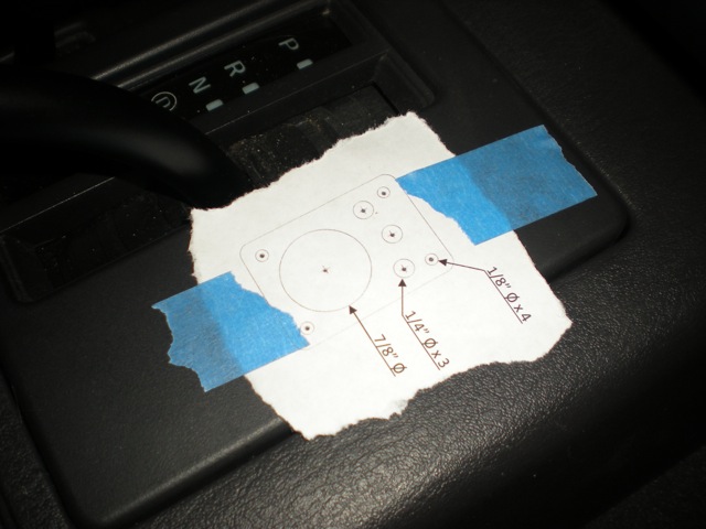

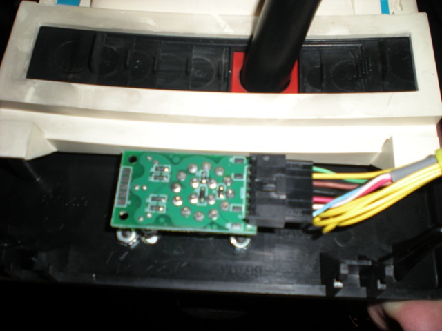

Just got the Montana Fab AW4 shift override installed... Extremely straight-forward, plug-and-play solution... I opted to install the control knob on the shift bezel.

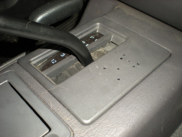

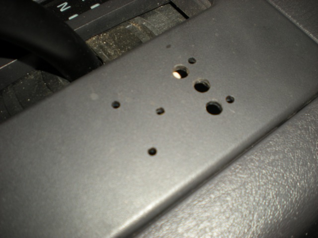

First, I got the template lined up and used a center punch to mark where I needed to drill (and ensure the bits would be easier to center):
Next, I drilled out the holes to 1/8"...

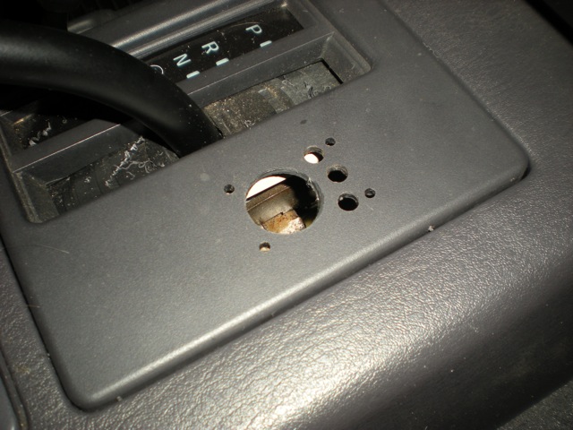

Then drilled the LED indicator holes to 1/4"...
And finally, used the 7/8" hole saw to drill out the hole for the knob itself:
Got the switch mounted with hairs to spare:

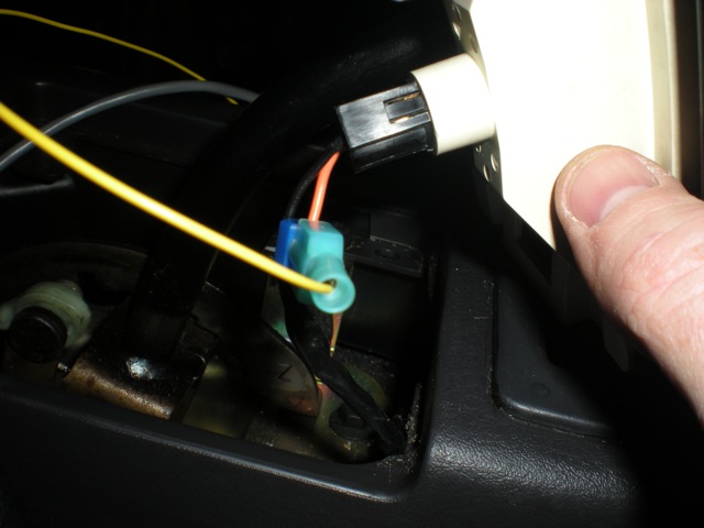

I used a T-tap to tap into the interior lighting circuit on the shift indicator:
Used some double-sided tape to mount the pass-through unit to the TCU and plugged it all in:
Got the knob mounted and the shift bezel snapped back in to place:

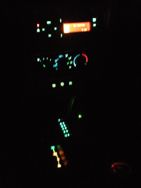

And voila - all done. The green glow is slightly different from the rest of the interior lighting (as this uses LEDs), but still ties together well:

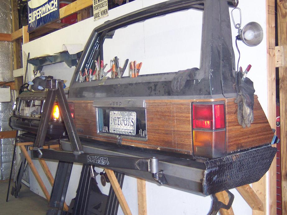

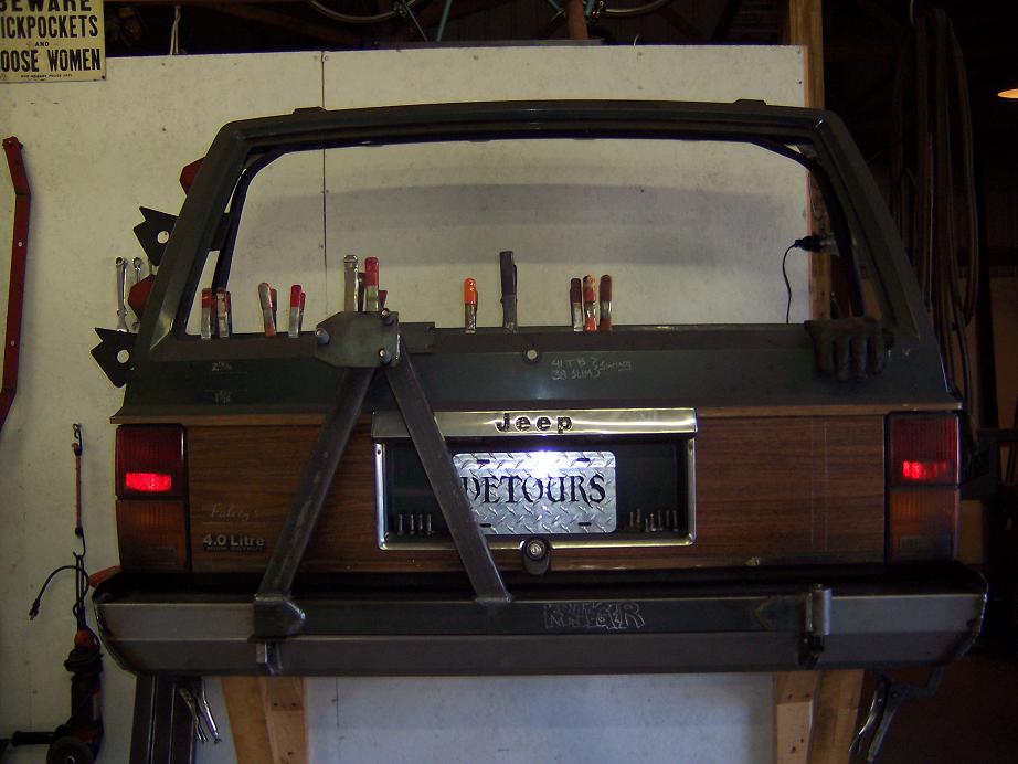

Woot, bumper is finished!
Lucky me - I'll be getting it on Saturday morning via personal delivery by Mark (he's coming through Raleigh on the way to the coast for a family vacation, so it works out well). Will post pics... Definitely looking forward to meeting him.
I was about to say that the trip from SD to Raleigh would be one hell of a drive, but then remembered you PM'd me saying you moved to Raleigh... Glad I caught that before making a stupid comment :)
We'll see how the weekend pans out, but it'd be awesome to have an extra set of hands (and it would likely make installing your front bumper easier too). After meeting up with Mark on Saturday, I'll be unpacking the bumper and painting it with some satin black Krylon as a short-term hold-me-over until I can order some Raptor Liner, so once the paint has dried we can move on to installing it (likely sometime Sunday).
