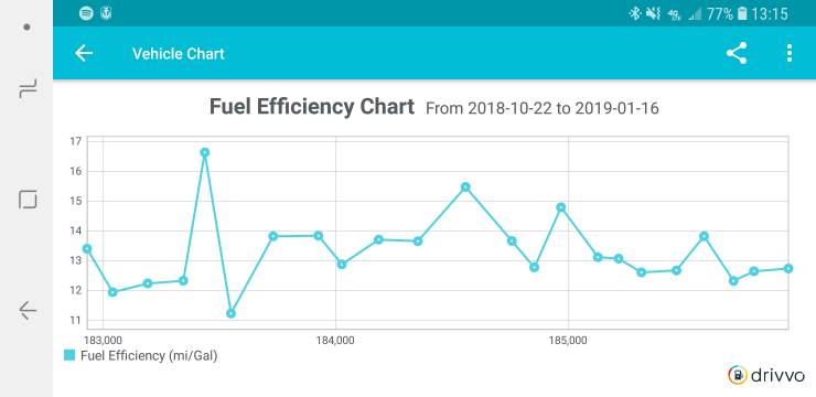

13.266MPG overall average (with a 75/25 mix of Highway/City driving) with one outlier of 11.2mpg (on 5th fill up) and one of 16.6mpg (straight highway for a whole tank)

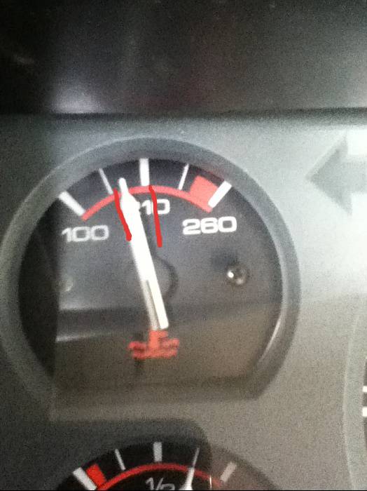

New STANT t-stat with OEM Mopar TSTAT because I'm getting huge temp swings currently so thinking that STANT may have been bad out of the box

I've attached a chart below from the app I use to keep track of mileage, service, ect. This is my 4th XJ and the only one so far that hasn't gotten high teens or even 20mpg on the highway.

I have seen 16 mpg highway and 10 mpg stop and go (fast food stops LOL) as a common range on mine.
What is/has been the operating engine temps?
Rad feed and outlet temps?

On a 50 mile commute with only 14 of that being county road and city street (10 miles of easy county road with one stop sign qnd 4 miles of city streets) i would expect to be a lot closer to 16MPG than i am now.
See the picture below for temp swing to and from work. This is reading with a new OEM temp sender in the head. This seems to be pretty accurate based on IR temp gun readings.

I'm only getting about 12-13mpg, but I'm pushing 31x10.50 MTRs with stock 3.55 gears, so figured that was the issue (did change speedo gear to correct for tires/ratio, so know speedo/odo is right).
