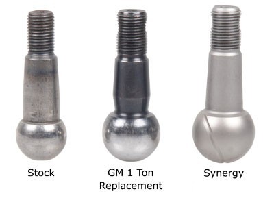

There aren't off the shelf TRE's that fit. These TRE's are much larger. This steering kit uses TRE's with a larger 7/8-18 shank, same size as a GM 1-ton TRE, but the studs are the TJ taper. The drag link uses two left hand thread TRE's, and the tie rod uses a left hand thread TRE and a right hand thread TRE.
Most of the improvement of this steering over stock are the TRE's. They are heavy duty, metal on metal units that are grease able and won't wear out and develop play as quickly as the stock style do.

Hmmmm... what size tre's does the currie unit use?
I'm only saying this based on size alone, nothing about the quality of metal forging etc but isn't the "zj upgrade" stuff 22mm? 22mm comes out to like .009 smaller than 7/8 right?
Yep, 22mm is ~ 7/8". "1 ton" size shank, though less stud size.
WJ stuff is ~15/16" , or 24mm.
Soooo ream the knuckles to standard one ton taper. Then you have off the shelf tie rod ends available
That could be an option but then you lose the added strength of the synergy TRE. Would make more sense just to buy a spare set to keep in the rig.
