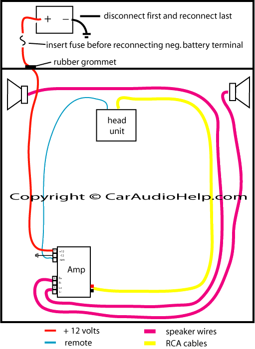

The12volt.com will be your friend.
But ya there is pretty much 3 wires. R.e.m. Power and ground and RCA depending on your deck. Then simple speaker wire from the amp to the sub.
I took a quick glance at some of the wiring diagrams. Before I was a little timid about doing any wiring...now I'm just plain scared! Hence the reason I haven't don't the headlight conversion with a harness...
