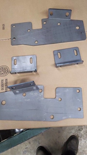

Hey guys, long story short, i ordered Ares Fab Tie-in brackets before i bought a bumper and i found a smittybilt bumper of craigslist for a good deal so i bought it but now im wondering if i can opt to use my ares fab tie-in brackets instead of the smittybilt ones since the Ares fab ones tie in to the unibody in more places. My only concern is that the smittybilt bumper uses 4 bolts to mount the bumper to the smittybilt bracket versus the Ares fab only uses 3 bolts to mount the bumper to the bracket. Can i get away with mounting the smittybilt bumper with 3 bolts? I guess what im asking is which option would be stronger? I'll be winching off this bumper.
If you use the biggest bolts that fit the holes the Ares brackets should be fine.

Great, thank you i think that's what I'll do. I'll look into the cross-member, looks like i might have to remove the front clip to weld it on?
