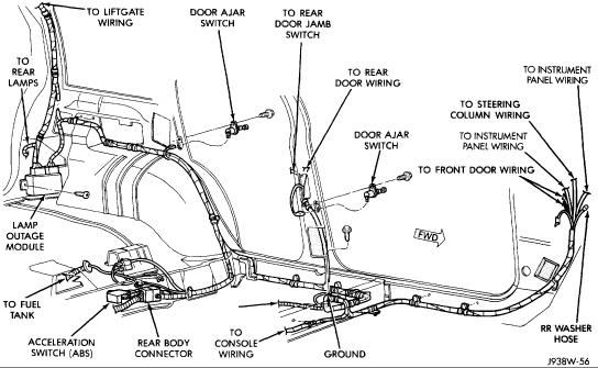

@89Mock this is the diagram i used. its a lot easier to see where to look than in mine.
Its actually in the cab. The wiring passes up through the floor and then grounds out right up near the ebrake. I will personally be adding a direct to frame ground much nearer the fuel pump. Leave it to an engineer to think 4ft of ground wire with 3 connections would be better.....
Not sure yours will be exactly the same. Mine's a 2 door and there seem to be some slight differences in component location.
If yours doesn't match up to this then it should be located where the dipstick tube mounts. My buddy here has a 4 door same year as mine. His is on the tube, mines at the e brake mount. I would also look at your main ground too. Mine was just dirty enough to lose a bit of ground there.

Oh wow. Weird spot for a ground. I was thinking of replacing my pump because I think it's hard to start even though it starts every single time. It just cranks longer than I PERSONALLY think it should and it just gives me that "one of these times it won't start" feeling.
Mine is a 4 door. The diagram is a start. Maybe I'll just track it all down one night in the near future. I already did the ones on the engine dip stick.
