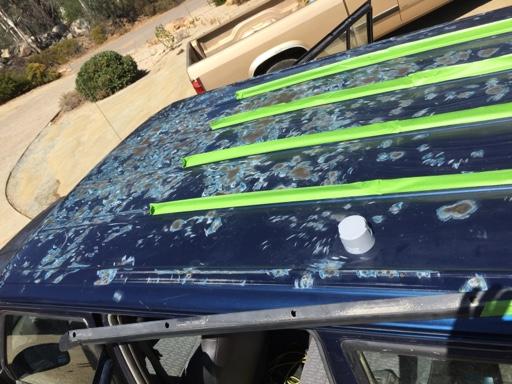

My roof is pocked with rust spots. Looking to clean it up and use RaptorLiner or such on it. ZERO experience in this area.
Figure DA the whole roof, apply epoxy primer or such then either paint or RL.
Help me out.. don't need fancy.
FWIW:
Wire wheeled the rusty spots and entire roof.
Sanded with 320 grit.
Sprayed with Eastwood Platinum Rust Encasulator
https://www.eastwood.com/eastwood-rust-encapsulator-platinum.html
and will follow up today with Eastwood High Gloss Chassis Black.
Rust wasn't terrible but this should control it.

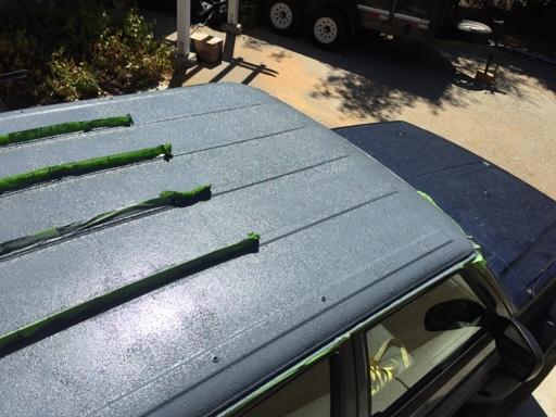

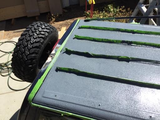

Got 'er done. Rollers that come with Raptor Liner are junk. They stick and won't roll, disintegrate and cause lumps in the compound. Fortunately, I picked up a couple 1/4" nap from Home Depot and finished up with them, then took a wide gasket scraper to it after it had cured overnight and slid it over the whole roof removing high spots, aka: chunks of roller, without scarring the finish. It looks pretty good, but with the rest of the XJ muddy, it sticks out as the only shiny spot on the whole rig. Appearance was not the goal, sealing from rust was, so that's a success. As soon as it gets dirty and bakes in the sun awhile it should look fine. Or, if I wash the rest of the jeep maybe... lol.
