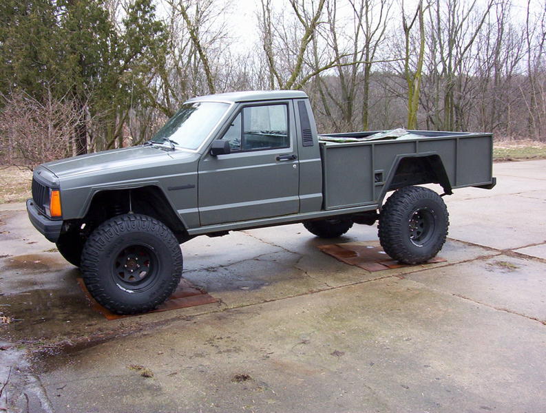

Is this closer to what you are looking for?
The bedsides were swiss cheese, so we did the rockers and bedsides at the same time, so no pics of the stock bedsides. The bed was off or loose during the install. There are 2 supports running to the "frame" in the front, and another support running to the frame in the rear. I believe all three supports per side were spaced even along the length of the rocker tubing. I can't find any closer up pics of the rockers on my pc right now, but I might have actual photos somewhere in my house.

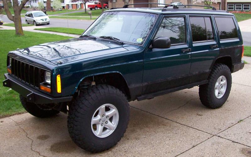

I did the front of my XJ last year similar to the MJ, with a small "horn" to keep the fender removable. I could get better pics of that because I still own it, the MJ was sold years ago. It looked a bit better on the MJ because I ran flares on that, I had planned on flares for the XJ, but I like it better with 33x10.50 tires and without.
On an MJ:
Its the almost the same thing as it is on a Cherokee. Just don't weld the bedsides to the rocker and you'll be fine.
