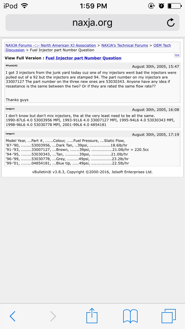

I always thought the same injectors used in 87-90, were the same as those used in the HO engines from 91-01?
Is that wrong? I found some very odd (in)compatibility data on fuel injectors on Ebay today. Was there a change in 90-91 and again in 1997-98?
They have some new 6 set injectors for the newer jeep 4.0s for about $65-$70 for an entire set :sunshine
arty1: . Not $65 each, but new, $65 for the entire set!!!! But they claim they will not work on 87-90 jeeps, and some claim they only work on 98 and newer, but they look the same?
