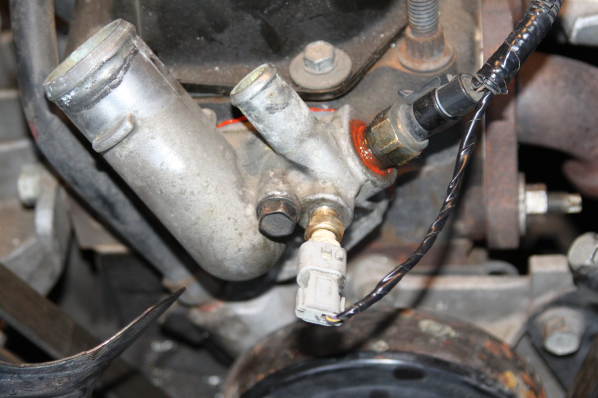

Gauge temp sensor relocated:
So one challenge down, now I got a misfire and a CEL to track down. But, WOOT, progress!
