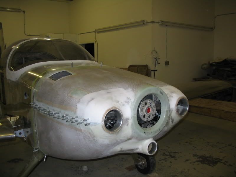

There's a system used by aircraft home-builders that uses piano hinge sections to make a hidden-fastener system for cowlings and covers. It's pretty labor intensive to fabricate, but when finished, the cowls have no visible external fasteners.
Here's links to a couple pics of finished aircraft.
http://www.2bumsaircraft.com/images/rv3-1.JPG
http://rvbuildershotline.com/archives/2008/20080607.html
Notice the split line at the intake opening with no fasteners down the side? 'Held together with an internal piano hinge. You reach inside, pull the pivot pin wire out, and the panels separate.
Here's links to a few construction photos, where you can see the work installing the hinge systems:
http://www.hanekom.org.za/Images_RV10/rv10_031.jpg
http://nerv10.com/lrosen/Construct/camloc/slides/RV-COWL-9-14-06-2.html
http://i92.photobucket.com/albums/l... 2007/cid_024b01c816b7939a535029fa1848dch.jpg
The hinge sections they use are an aircraft grade part, called AN257-PX or MS20257-X (where the X is a number, 2-5, denoting the flange width)
'Might give you some ideas.
