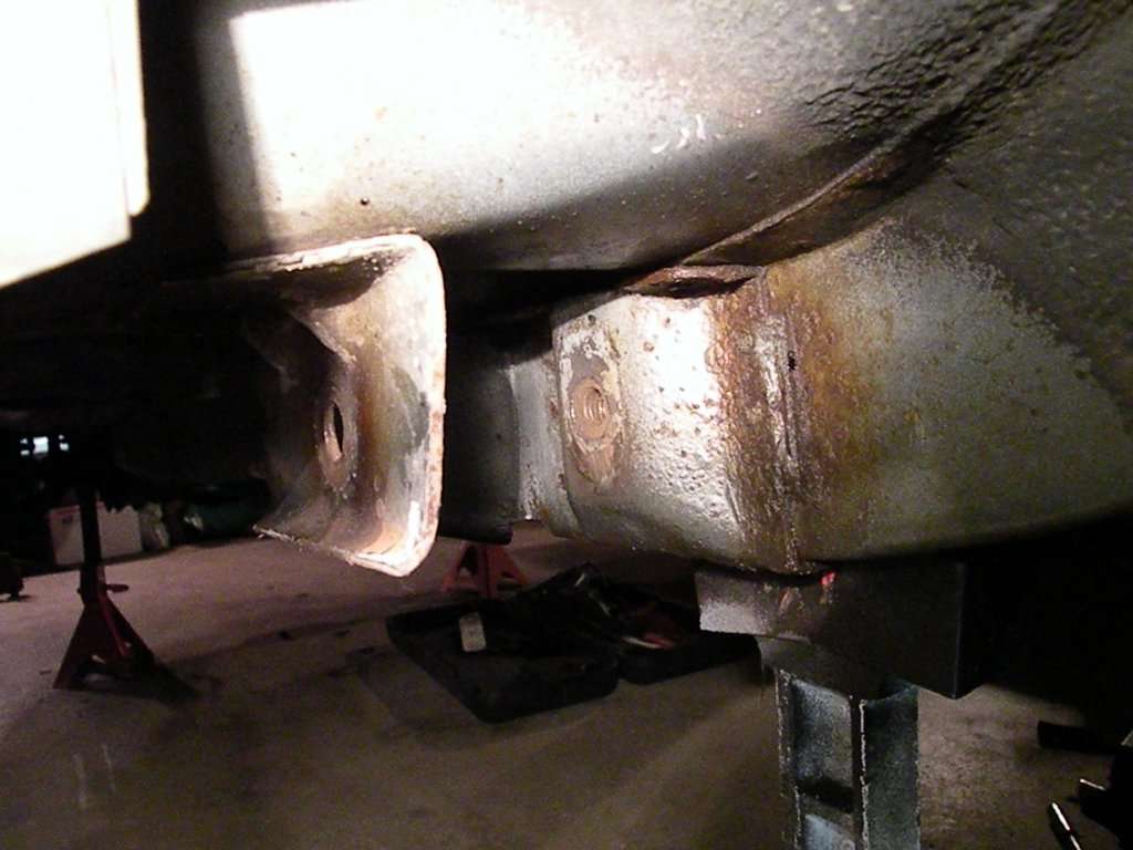

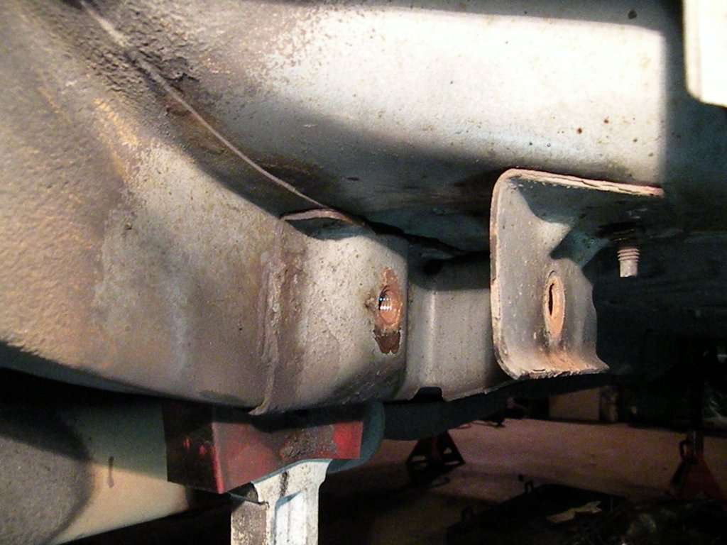

I have fasteners to replace all 6 bolts for the shackles/leafs. What can't I immediately sawzall off the leafs? It looks like both the upper shackle mount and front leaf spring mount have a weldnut in the frame rail. I'm prepared to cut the body to access the weldnut if fate has things going that way. I'm interested in speed...everything is worn out 194k and going in the trash (have a sawzall, 4" grinder with cut off wheel, and dremel with hd cutoff wheels.)

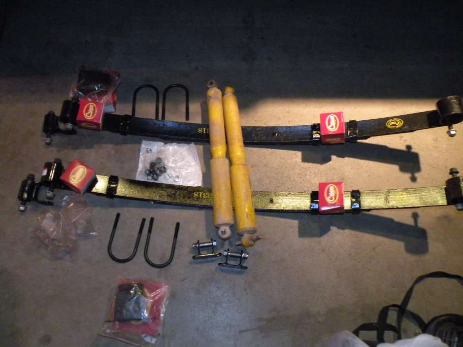

Kit:
Front
-Teraflex 3/4" spacers
-Bar Bin Eliminators (brand escapes me)
-Old Man Emu shocks (second hand from Dirk at DPG)
-Day star polyurethane extended bump stops
Rear
-Quadratec (Crown) HD leaf spring packs
-6 New bolts, washers, nuts for leaf spring attachment points
-OE style (Crown) shackles
-OE style (Crown) body & shackle replacement bushings
-New u-bolts, nuts, and washers
-Longer OE style (Crown) bump stops

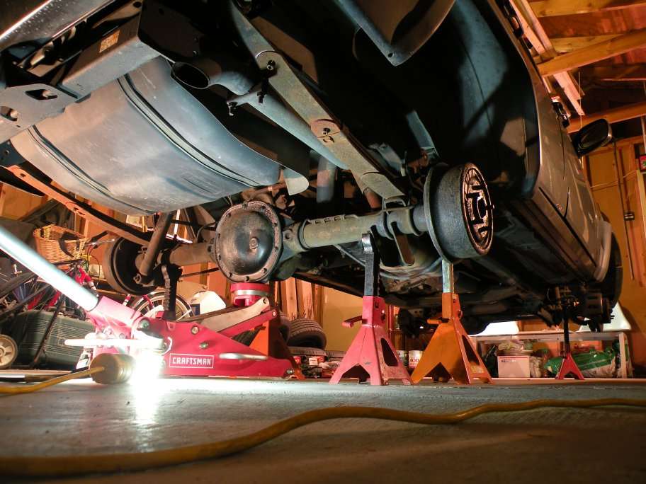

You really need an impact, otherwise you will be cursing and moving very slow. Borrow a neighbors compressor and pick up an impact from Walmart along with a 21mm impact socket.
Plan on replacing the front lower shock bolts/nuts at the axle as well. They simply bolt through the bracketry so no need for a tap.
Use a torch to heat up stubborn nuts or bolts. Don't be shy with the heat.
I would also try and keep one end of the Jeep on the ground. It would be another story if it was on a lift, but I have never felt safe under a rig supported only by jack stands.

Ive used a breaker bar,extension 21mm socket held up with a small jack stand. On the breaker bar a 6 foot cheater pipe. The problem is the bolt is rusted to the sleeve. An impact that will break it loose has to be a 3/4 or 1 inch drive. It will take alot even with the 6 foot cheater. Coat it heavily with anti seize when you put it back together.the bolt will be a pain to get out once its loose. Ive had to cut the end of the spring off in 2 spots then remove the bushing and grind the sleeve off the bolt.

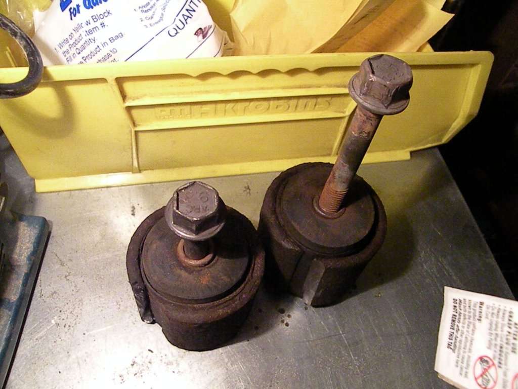

One more thing, you might find the bolt has 'welded' itself to the inside of the bushing. Others had come across this in the past, I just used heat on the bushing as it was being replaced anyway.

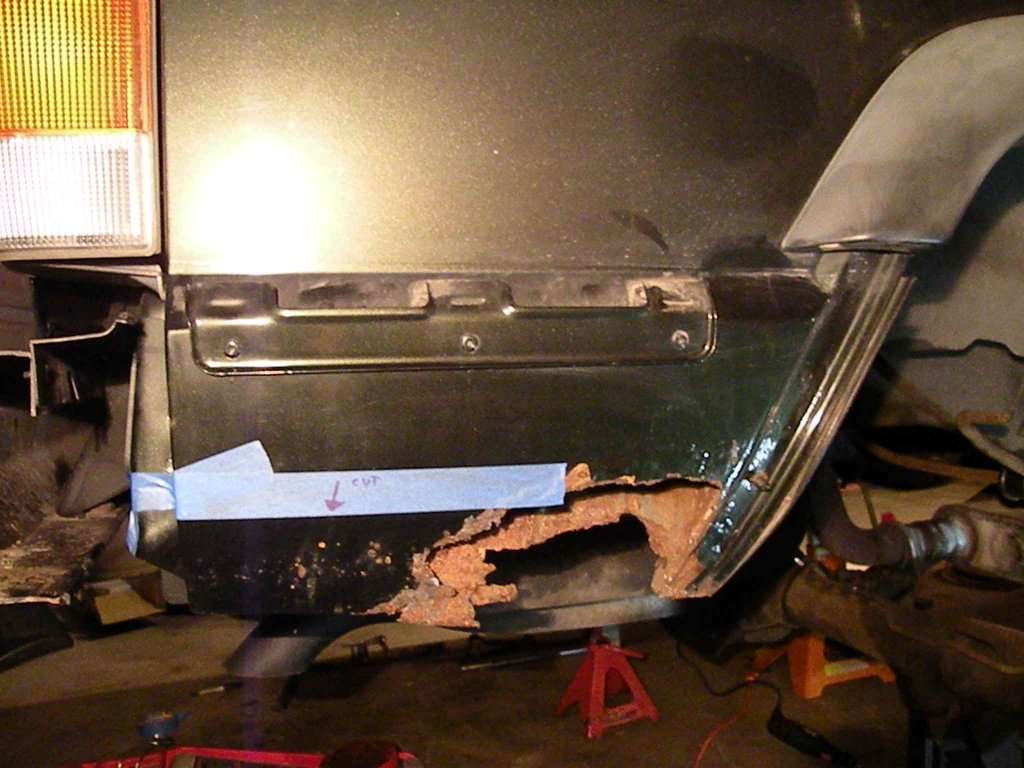

Thank you... I was staring at the inside of the rear lower quarter panel thinking about which way I was going to cut an access hole in it. The bottom is rotting out from rust. I just bought a 2 1/8" hole saw, but also could use a 3" air grinder, or 4.5" angle grinder both with cut-off wheels.
To get to the rear quarter panel do I just remove the 10mm bolt/nut from the plastic endcap where it attaches to the bumper? I've got it soaking in PB, but I'll cut the 10mm if it gives me trouble. I'm gonna glance at the FSM.
This is a daily driver, so I'd like to get the endcaps back on when I'm finished.
I've got both the front eye bolts out without any damage! The rear shackle mounts are clicking in the body, but an impact worked on the other 2 that were doing the same thing up front.:thumbup::thumbup::thumbup: Working it back and forth with the impact, unseized the bolt from the bushing and broke up the rust. I had to torch 1 more time to get to this point.
For anyone else reading this near Ohio, to break the rust loose required this sequence:
1) Torch (21mm bolt for 8 min)
2) Air Impact driver (21 mm on wobble extensions/yokes)
3) Quench with PB Blaster (smoking hot quench)
4) Attempt with 3/4" breaker bar w/2 ft cheater
Repeat up to 3 times. Use the impact driver to loosen and tighten once the bolt starts moving to unseize from bushing/nut.

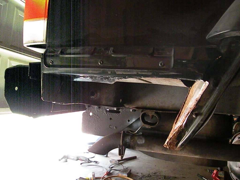

So I've been checking out the cut and fold method:
http://www.jeepforum.com/forum/f11/cut-fold-rear-lower-quarter-panels-right-way-1007865/
and
http://www.ajsoffroadarmor.com/pages.php?pageid=12
I'll need to use the cut and fold to be able to get an impact on there at a straight angle.
I want to keep my stock end caps. This is a daily driver and I will have a stock bumper for at least 2 years. I wonder if I can do a cut and fold that is a little lower on the outside skin of the quarter panel. I'm trying to keep the end cap bracket underneath intact without tweaking the metal it sits on too much.

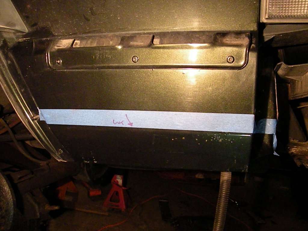

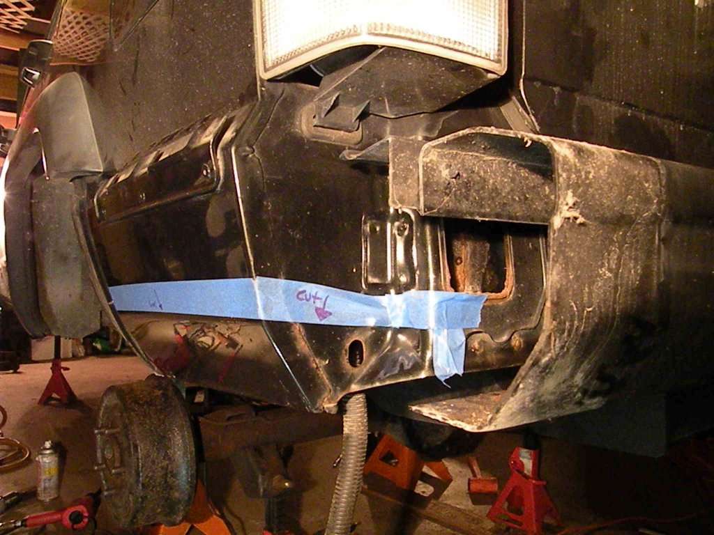

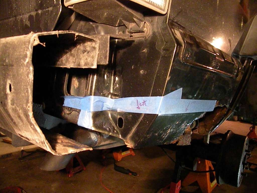

This is what I have laid out to cut tomorrow:
Success with the front eye bolts...it felt good to be halfway there.

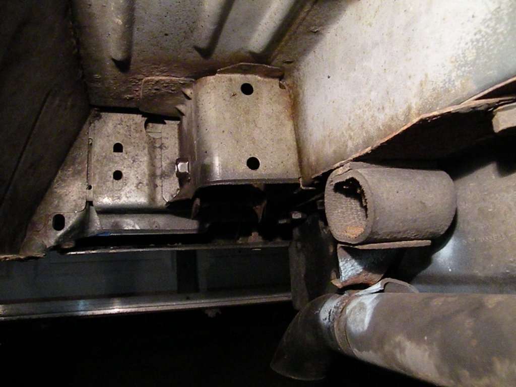

What's left on the shackles
This is what I'm going for to get access to the upper shackle mount. I will be keeping the endcaps and the endcap slider bracket, o my cut and fold will have to be a little lower than most of the write-ups. I'm a bit nervous but I'll take my time today.
So mine aren't as clean as the purple XJ in the picture above, but I cut and fold the rear quarters. Since its a daily driver I kept the slider brackets for the end caps, and the metal inside the wheel well so I could retain my splash guards.
