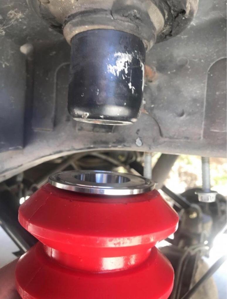

Check these out.. I recently found them and installed them along with Prothanes on my ZJ. I’ve ran prothanes in the past and always had the issue of them jamming onto the upper coil retainer/bump stop post. These are a 1.5” barbed adapter with a 2” flange. They fit really snug into the Prothane and will keep it from jamming. Haven’t tested them yet, I’m wrapping up the ZJ now and getting it ready for it’s first dirt run post lift.

If you don't like them clanging metal to metal I just bolt a 1/4" thick plate on the end of the tower. It chews them up over time but not horrible.
I also put a piece of round delrin plastic in the center hole to make a hard bump.
Are you sure it is a 1.5"? The link you posted only has 1.25" and 1.75" avalible.
Positive, the ID of the Prothane is 1.5". Looks like the seller changed the Amazon listing and removed the 1.5" option. It's a fitting to go from a 1.5" hose to a 2" clamp. You could look for a different flange size, as long as the barbed fitting is meant for a 1.5" hose it will fit into the Prothane. I'd suggest keeping the flange under 3" or it may start to hang off the edge of the Prothane.
