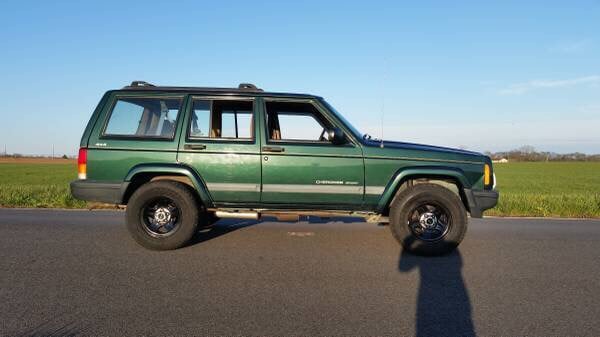

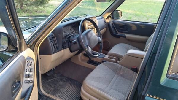

I picked myself up a 1999 XJ Sport in Forest Green Pearl with the two tone interior.
I wanted a spot to put all my photos and updates, and also be able to receive some feedback and help along the way. So I figured I'd start with a build thread.
Here are some photos from the craigslist ad.

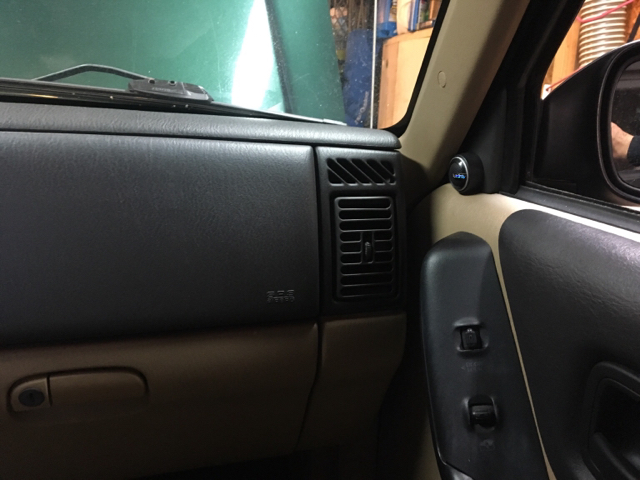

While I wait for the correct rear main seal to get here I got a had a set of infinity reference component speakers laying around, so figured if get them set up in the front doors.
The tweeters actually came out pretty cool. I need to get a new stereo soon however since the screen on the factory one doesn't light up.
